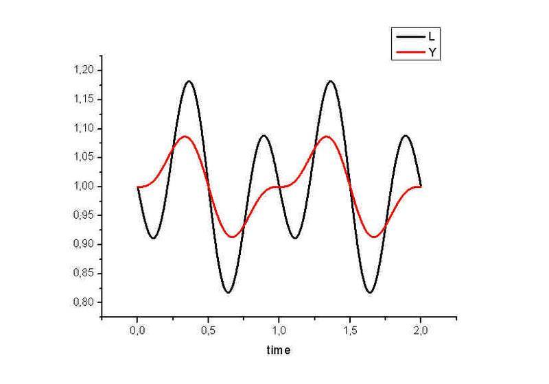

See picture. The ceiling is the zero of coordinate y and downward is the positive direction. The top of the spring is at x=csin(nt). The length of the spring is L. so y=x+L.
For he mass m, [itex]m\ddot {y}=mg-k(L-a)\rightarrow \ddot {x} +\ddot L =g-\frac{k}{m}(L-a)[/itex]
The relaxed length of the spring is a. When the hanged mass is rest, the length is b, so mg=k(b-a), as you have shown. The natural frequency is ω. ω2=√(k/m). So g=ω2(b-a).
Find the second derivative of x. Also substitute ω2 for k/m and ω2(b-a) for g.
ehild
Edit: The zero of y is not at the ceiling but at the point the upper end of the spring oscillates about.

I understand where I went wrong now - The question says we have a displacement at the top end and somehow I simply neglected that and drew a sketch with the mass at the end displaced instead. Thank you voko and ehild.
I now need to find the particular solution to this eqn. From the words of the question, should I let the initial conditions be ##L(0) = a## and ##\dot{L}(0) = nc##?
My method was to split up and solve two eqns:
1): Solve ##\ddot{L} + \omega^2 L = \omega^2b \Rightarrow L =b ##by inspection.
2): Solve ##\ddot{L} + \omega^2L = cn^2 \sin(nt)##
I found a solution of ##L = \frac{cn^2}{\omega^2 - n^2} \sin(nt) ##
Putting these together:
General solution to inhomogeneous eqn: General soln to homogeneous eqn + Particular solution to inhomogeneous.
So I get $$L(t) = A \cos (\omega t) + B \sin(\omega t) + b + \frac{cn^2}{\omega^2 - n^2}$$ A and B can be determined by the Initial conditions, but I want to check they are correct before I start.
Thanks.
The sin(nt) factor is missing from the final expression.
[tex]L(t) = A \cos (\omega t) + B \sin(\omega t) + b + \frac{cn^2}{\omega^2 - n^2} \sin(nt)[/tex].
Good job!

Assuming at t=0 that x(0) =0 and x'(0)=0 would mean that L(0)=a and L'(0) = 0 right? (where x is the displacement of the top end of the spring).
In the case of omega =n, I have:$$L(t) = A \cos (\omega t) + B \sin (\omega t) + b - \frac{c \omega^2}{2 \omega}t\cos (\omega t)$$
What I was trying to say in my last post about the case omega =n was that physically, we can get in theory, infinite amplitude. (I think)
"The top of the spring moving downwards at t=0" means that c is positive if the positive direction is downward. You solved a differential equation for L(t). You can use any initial condition, concerning L.. As an example, it can be that initially the spring is stretched by some length d from its original length and released (so dL/dt =0 and L=a+d.) Or the length of the spring is b at t=0 and dL/dt=0.
If ω=n a particular solution is L=-(0.5cn )t cos(nt) + b. Try.

Actually I reread the question. It explicitly says '...moving downwards at t=0' so does this not imply that the spring may be stretched? ( and if so, L(0) = a would not hold)
The top of the spring is moving downwards according to the function csin(nt). At t =0 the displacement of the top is zero. The whole spring is below its top, is'nt it? And a mass is attached to the bottom end. Initially you can do something with that mass, lift up, pull down, or giving it some velocity. So the spring can be stretched initially, but can be unstretched. Or it can be even compressed.
ehild
L = z - x = - c sin nt - x.
L' = - cn cos nt - x'
if x(0) = x'(0) = 0, what are L(0) and L'(0)?

L(0) being 0 at t=0 does not make much sense to me since the spring is always going to have its natural length.
'Write down the initial conditions based on the description above (that is the the problem statement) and find L(t).'
A mass m hangs in equilibrium at the lower end of a vertical spring of natural length a, extending the spring to be a length b.
In case of initial setup that the hanging mass is in equilibrium before the top of the spring starts to oscillate, the initial conditions are L(0)=b and L'(0)=0.
ehild
Edit: I meant y'=0, so L'(0)=-cn.
CAF123 said:
Would that give L(0)=0 and L'(0)=-cn?
You are right, x(0) is not zero. At t = 0 the system is in equilibrium.
So L(0) = b if the system is in equilibrium and L'(0) = -cn?
That is how I interpret the formulation:
"A mass m hangs in equilibrium at the lower end of a vertical spring of natural length a, extending the spring to be a length b."
That means x(0) = -b, x'(0) = 0.
"2) The top end of the spring is made to oscillate vertically with a displacement csin(nt), moving downwards at t=0."
The conditions on the length follow directly from the given law of the top end's motion and the equilibrium condition on the bottom end. "Moving downward" here states explicitly that the top end is moving at t = 0, which in conjunction with x'(0) = 0 can only mean that the length is changing at t = 0.

Okay, the only thing I don't understand now is that in the question it says the top end is moving downwards at t=0. So wouldn't that move the whole system out of equilibrium?
Thanks.
Thanks.
The mass, not the entire system, is said to be in equilibrium. Even though that still sounds a little fishy.
The trouble that you have with grasping the behavior is due to a tiny bit of unrealism in the system: it is not possible to make the top end move in STRICT accordance with c sin nt and at the same time have x'(0) = 0. The sine extends infinitely back in time, so there must have been some oscillations in the past to have the motion in the form c sin nt and to be able to take its derivative. And if there were some oscillations, we can't assume x'(0) = 0. If there were none, the law of motion is not sinusoidal, and z'(0) may not even exist.
Thanks.
Imagine you have a motor attached to the top of the spring which makes the top end moving. Before starting the motor the mass is in equilibrium, y=b and y'=0. As you switch the motor on, the displacement of the top end is still zero, but its velocity is -cn. So L(0)=b and L'(0)=-cn.
Initially the hanging mass does not "feel" anything, as the spring force is still k(b-a), and it is in equilibrium with gravity.
As time proceeds, the spring gets shorter, the spring force decreases, so the mass starts to descend.
