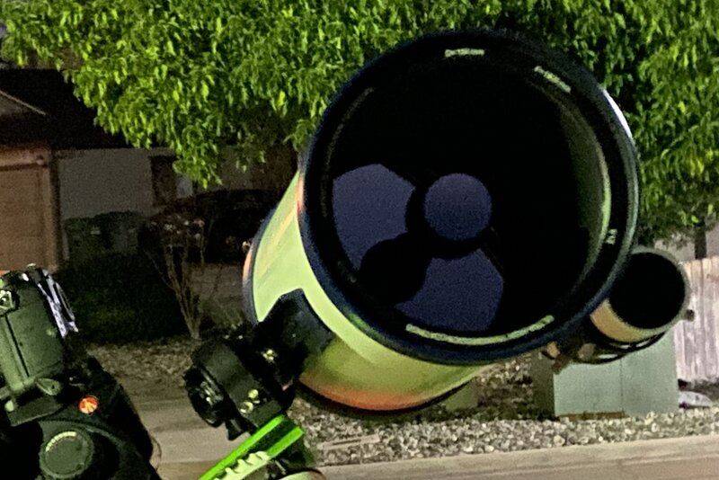

Found this little monster just a little while ago when checking on my rig.
At least he made a little web on this end of the scope instead of the other!
  • Haha

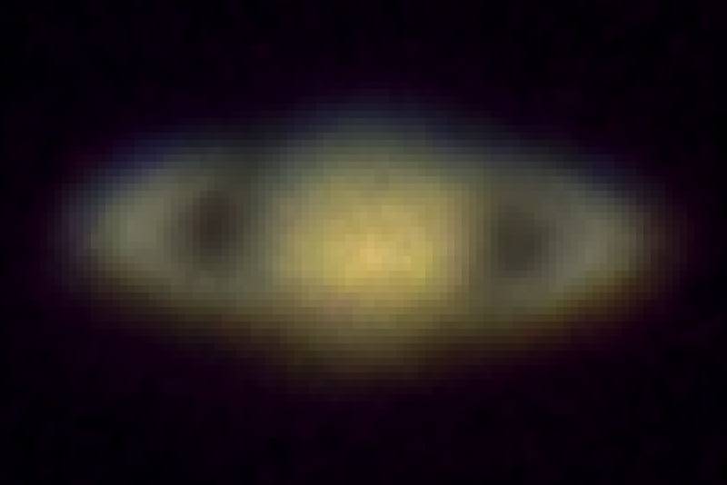

Hi, this one Saturn is little Gimp sharpened and saturated, and next is original. I reached my best results by Mobile Camera with adapter (eyepiece Hyperion 8 or 6 mm) ...
Lot of success Bruha

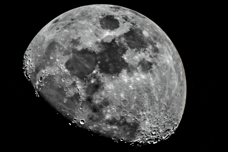

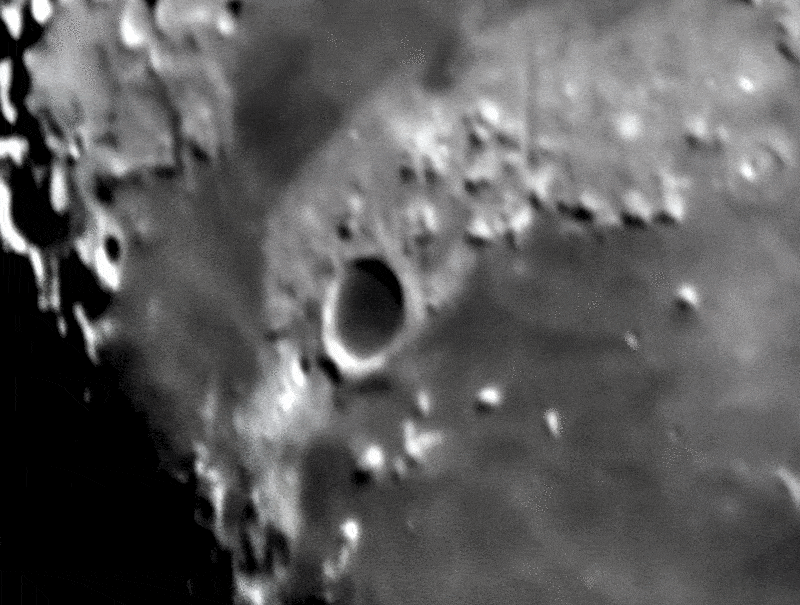

  • #888
The Moon tonight. Taken with my vintage Montgomery Wards 60mm f/11 “Kohoutek” scope circa 1973 using a Bushnell 20X50 eyepiece with my old prism diagonal. Right out of the iPhone using Procamera. 1/503 sec, ISO 200.

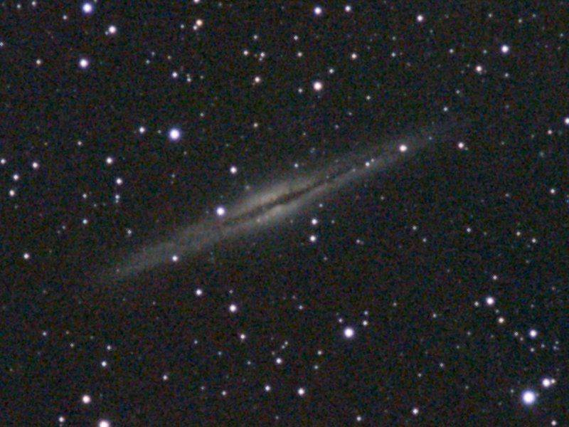

Well, I just bit the bullet and bought an Atik One 9.0 to replace my nearly twenty-year-old SBIG ST-2000XM. I feel a bit guilty, as I had to use my credit card and probably shouldn't have spent the money, but I've been putting off an upgrade for the better part of a decade while I tried to do the college thing and now the family thing and I just couldn't wait any longer. Especially since SBIG isn't even sure they have the parts to repair the ST-2000 and its accessories anymore.
I chose the Atik One 9.0 because it was the most affordable option for a camera & filter wheel with the ICX814 sensor. When binned 2x2 the sensor has almost exactly the same pixel size as my ST-2000 but with more than double the sensitivity in parts of the spectrum (especially the HA & SII bands), a slightly larger FOV, half the read noise, and about 1% the dark current* (according to Atik's specs). A substantial improvement.
*Atik's website lists the dark current at 0.0002 e-/p/s at -10°c, while Diffraction Limited lists their camera with the same sensor as 0.025 e-/p/s at 0°c, so I'm not sure which one is more accurate. At worst, it's still less than half the dark current.
