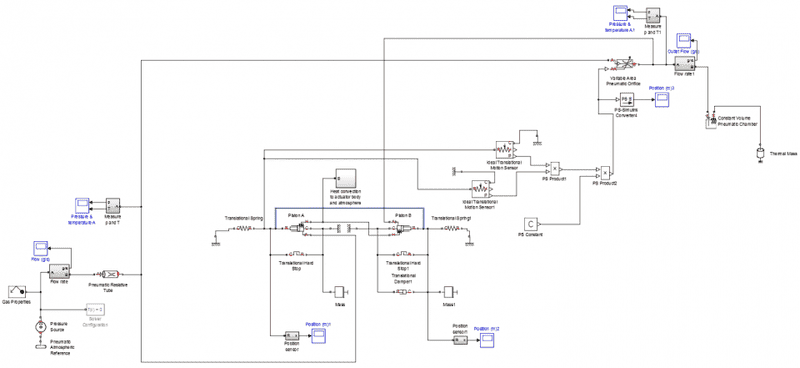

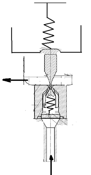

I am new to simscape and trying to setup a similar pressure regulator model. It seemed like I connected all the elements correctly but I am not getting the expected results.
I have attached a pic of the regulator and of the simscape model as well below.
Can someone please let me know if the elements are correctly connected ? Any advise, help , suggestion is appreciated.
Cross-sectional engineering drawing of a spring-loaded pressure regulator valve, with a coil spring above a poppet and seat in a block, an inlet arrow at the bottom and an outlet arrow on the left side.
Regulator Model
Simscape block diagram of a pneumatic pressure regulator: gas properties and pressure source feed a relative restriction, two pistons with translational springs, mechanical stops, position sensors, and a constant volume chamber with flow and pressure sensors.
Simscape Model
