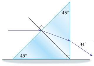

A horizontal beam of light enters a 45-90-45 prism at the center of it's long side, as shown below. The emerging ray moves in a direction that is 34˚ below the horizontal. What is the index of refraction for the prism?
n_{1}sinø_{1} = n_{2}sinø_{2}
n1 x sin(i) = n2 x sin(r1): (1st refrection)
and n2 x sin(r2) = n1 x sin(34˚): (2nd refraction)
^^Here n1 is the refractive index of air, n2 is the refractive index of prism, r1 and r2 are the angles of reflection at the two surfaces, and i is the incidence angle.
r1 + r2 = 45˚ or r2 = 45˚ - r1.
Substituting the above value of r2 in the equation(2),we get
n2 x sin(45 - r1) = 1 x sin(34˚)
...and then I'm stuck!
To simplify what I've figured out:
first refraction: sin45 = n sin a
second refraction: n sinb = sin34
and using geometry: a + b = 45
BUT HOW DO I FIND a and b?
Hi ObviousManiac! :smile:
Learn your trigonometric identities
sin(45° - a) = … ? :wink:
okay so sin(45˚ - a) = sin(45)cos(a) - cos(45)sin(a)
but I'm not sure where to take it from there...
I tried setting up something like:
sin(45)/sin(34) = sin(a)/sin(b)
sin(45)/sin(34) = sin(a)/sin(45-a)
sin(45)/sin(34) = sin(a)/[sin(45)cos(a) - cos(45)sin(a)]
but I don't even know if any of that ^^ is right, I could be going in a totally wrong direction.
Substitute from the first equation into the second. :wink:
Sin(45-a) = nsin(a)cos(a) - cos(45)sin(a)
...doesn't this just introduce a new variable? (n?)
