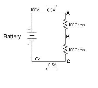

agree with phinds ... in particular the
after you combine two series resistors
do you see any problem in this voltage divider ?
what do you think the voltage at point B is ?Dave

I'm wondering if the circuit comprises a battery with internal resistance and a load resistor? In that case if you combine the two resistors into one the node representing the battery terminal (aka output voltage) disappears.

I think it just means that the output voltage of a voltage divider can't be defined anymore after you combine the input resistor and the pull-down resistor in series. Like if you are solving a circuit that has a potentiometer in it or something, and need to combine the two sides of the pot to help you solve for some voltage other than the wiper voltage...
