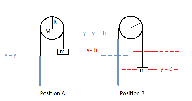

Two side-by-side diagrams of a pulley with radius R and mass M, a hanging block of mass m on a rope, and a vertical spring, labelled Position A and Position B, with dashed reference lines marking y = 0, y = h and y = y + h.
Total Energy of Position A (As shown in picture)
E = 1/2ky2 + mgh + 1/2 mv2 + 1/2 Iω2
E = 1/2ky2 + mgh + 1/2 mv2 + 1/2 I (v2/R2)
E = 1/2ky2 + mgh + 1/2 mv2 + 1/4 MR2 (v2/R2)
E = 1/2ky2 + mgh + 1/2 mv2 + 1/4 Mv2
E = 1/2ky2 + mgh + (1/2 m + 1/4 M)v2
Total Energy of Position B (As shown in picture). I took position B as being the one with maximum amplitude, at which point the movement changes direction and so the velocities are 0, as are the kinetic energies. The little mass m is also at its designated y=0, so the only energy at this point is the energy of the stretched spring, and it's equal to the same constant.
E = 1/2k(y + h)2
E = 1/2k(y2 + 2yh + h2)By conservation of energy.
1/2ky2 + mgh + (1/2 m + 1/4 M)v2 = 1/2k(y2 + 2yh + h2)
mgh + (1/2 m + 1/4 M)v2 = kyh + 1/2kh2
h(mg - ky) + (1/2 m + 1/4 M)v2 = + 1/2kh2

The equation is that of a harmonic oscillator, with a constant force applied also on it. You can simplify by R and it would look simpler with a variable of length dimension x=Rθ. Try the solution in the form x=Asin(ωt)+B. The angular frequency you quoted is not correct, however.
ehild
