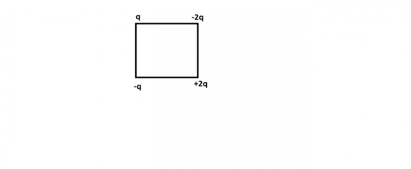

four point charges are placed at the corners of a square as shown in the figure having side 10 cm.If q is 1μC then what will be electric field intensity at the centre of the square?
Square diagram with charges at its corners: q at top left, -2q at top right, -q at bottom left, and +2q at bottom right.
Equation for electric field magnitude: E = (1 / (4πε0)) × Q / r^2, with the fraction 1 over 4 pi epsilon-naught multiplied by Q over r squared.

Electric field due to charge "q"
=9 ×10^9 ×1×10^-6/(0.1/√2 )^2=18×10^5

In the solution it has been given that at center there are two electric field which are perpendicular to each other.I want to know how?
Don't forget that electric field is a vector quantity, when you want to add several vectors you don't just add their magnitudes, right?

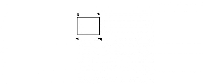

Rectangle with four point charges at its corners: q at top left, -q at top right, -q at bottom left, and +q at bottom right.
How the figure in question is transformed into the picture above!
Why is your second picture different than the first one? Which one is actually asked to you and what is it precisely that's asked?

Maybe they are thinking of using superposition as shown below.
  • Diagram of a square with corner charges q, -2q, -q and +2q, equals sign, then a square with corners q, -q, -q and +q plus a square with a single corner -q and corner +q, showing charge superposition.

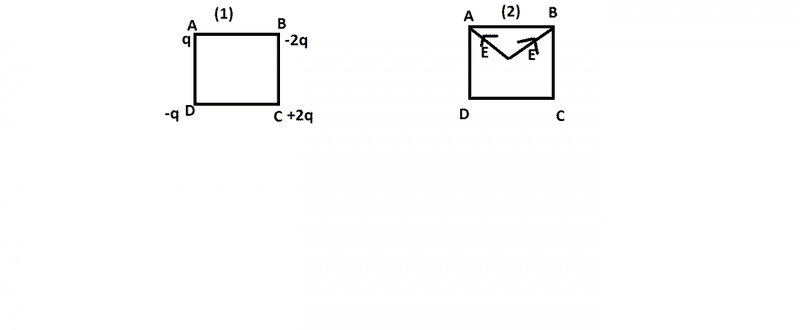

I think We should assume a test charge (positive/negative)at center of square.I have taken positive charge.Now direction of force due to -q and -2q would be opposite and direction of force due to +q and +2g would also be opposite .And electric field would have same direction as force.So resultant direction of force(electric field ) would be directed towards B and A respectively.
Two diagrams of a rectangle ABCD. Diagram 1 labels corners A (q), B (-2q), C (+2q), D (-q). Diagram 2 shows the same rectangle with hand-drawn arrows labelled E at corners A and B, pointing into the interior.
Now electric fields are in perpendicular direction.This was all about direction.For magnitude I think the electric field intensity (in second picture )would be because of -q and +q because -2q overcame -q after that -q is left similarly +2q overcame +q and is left with+q .
I don't know whether I am correct,waiting for your corrections of my work.
You don't have to assume a test charge as the force it experiences may be in opposite direction to the actual electric field at that point depending on the test charge's sign.

Your idea is exactly what the superposition principle facilitates, see comment #5.
However, you seemingly encounter a small misconception. It's true that you can assume that the -q part of -2q overcomes the other -q sitting in the opposite corner of the square. But then afterwards, we should have that the contributions from the two confronting -q's disappear. So, what value of charge is actually left and where?

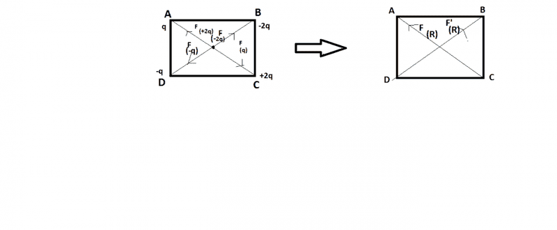

You need the electric field at the centre of the square. It is the same as the force exerted on a unit positive charge.
The charges at the opposite vertices of the square act along the diagonal, and their force is opposite. So the resultant of the pairs are as drawn in figure 2, they are perpendicular.
I do not follow what you wrote about the magnitude. So what are the magnitude of both forces? And what is their resultant then?

Left: rectangle ABCD with charges q at A, -2q at B, +2q at C and -q at D, a point at the centre with forces labelled F(+2q), F(-2q), F(-q) and F(q) along the diagonals. Right: the same rectangle with resultant forces F(R) and F'(R) along the diagonals.
Resultant force F(R) of forces(+2q,and q)would be Directed towards A and Resultant force F'(R) of forces(-2q,and -q) would be Directed towards B.Direction of electric field would be same as of force because I have assumed POSITIVE CHARGE to be at center of square.And magnitudes of electric field would be
E(R)=9 ×10^9 ×2×10^-6/(0.1/√2 )^2-9 ×10^9 ×1×10^-6/(0.1/√2 )^2
And magnitude of E(R)is same as of E'(R).

Yes, and what is the resultant, direction and magnitude ?
Yes. Of course the net field at the center will be the vector sum of these two perpendicular fields.
I'm not sure what you are saying here. The second picture is not equivalent to the first picture.
