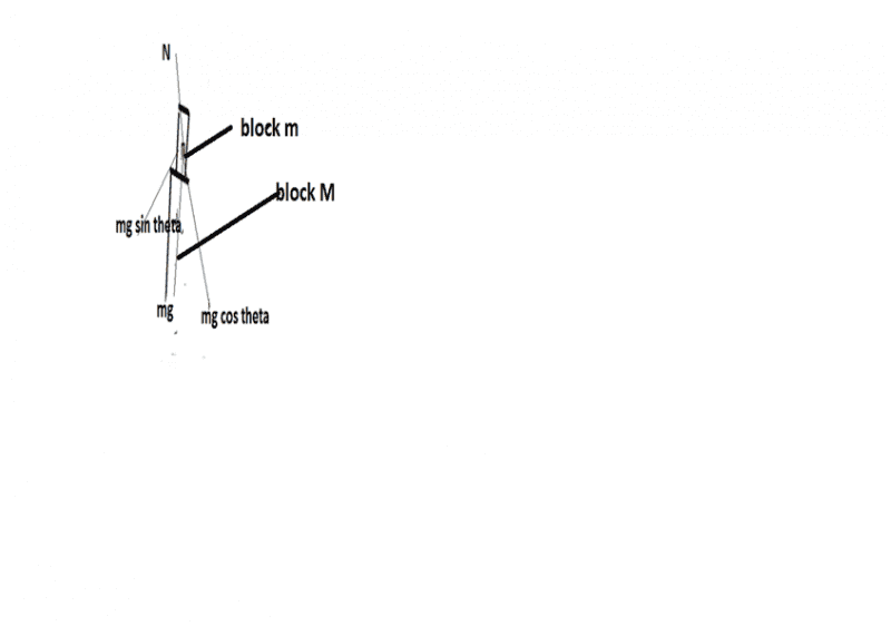

  • #33
gracy said:
as mg sin theta is the net force friction opposes it.
m does not slide with respect to M means there should not be kinetic friction rather static friction.acceleration of the system=(m+M)g sin theta/m+M
=g sin theta
force responsible for acceleration of small block would be force of static friction between two blocks.
No this is not right. You can not switch of gravity. Gravity acts on block m, and its component is mgsin(theta) along the incline.
The acceleration of the block is determined by the sum of forces acting on it (in the direction of the incline). That sum is mgsin(theta)-friction.
So ma= mgsin(theta) -friction.
But you determined that the acceleration of both blocks is a=gsin(theta). Plug in this a into the previous equation. What do you get for the friction force?
  • #34
This is what I have shown in image.

  • #43
Was the block M a wedge?
  • #44
ehild said:
why did you say it was correct ?
I thought It is just 2 blocks on inclined surface as my title indicates.

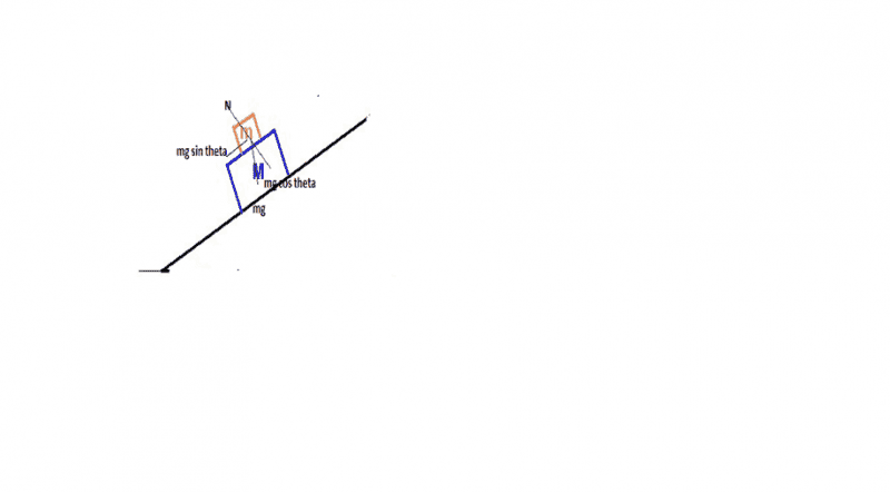

ehild said:
I see. Then my drawing was wrong, why did you say it was correct ?
Draw the FBD for the small block.
  • #48
Picture looks awful still. m is lying on a horizontal surface. Picture in link is fine and under 1 in post #1 is hmmm.
So back to post #3 by Chet: three forces working on m have to result in an acceleration ##g\sin\theta## along the plane.
Draw the diagram and calculate the forces.
The ##\tan\theta## answer is correct.

  • #50
gracy said:
I help with a new picture, as nothing can be seen from yours. Note that m is on a horizontal surface!

  • #54
gracy said:
But the link I have provided says M is also a block.
Yes, but a wedge was drawn, and the solution they provided counts with the wedge.
  • #55
You mean question is wrong?
  • #56
In wider meaning, block can mean other shapes.
a. A solid piece of a hard substance, such as wood, having one or more flat sides.
b.
Such a piece used as a construction member or as a support.
c. Such a piece upon which chopping or cutting is done: a butcher's block.
d. Such a piece upon which persons are beheaded.
e. One of a set of small wooden or plastic pieces, such as a cube, bar, or cylinder, used as a building toy.
So solve the problem according to the original figure. The top surface of M is horizontal, as in your second figure in the OP.
