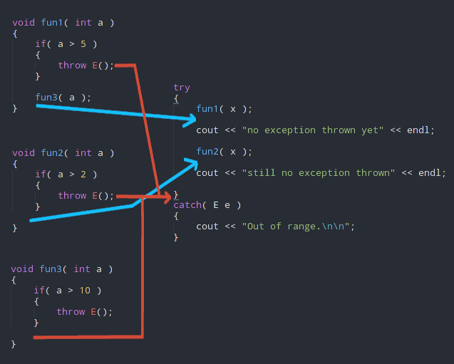

I think the diagram is just a confusing diagram because of the clutter.
It says "Normal return" at the end of fun1(){} with an arrow that goes to after fun1(); is called. That means if an exception is NOT thrown, it goes there. The other arrow, says exception can be handled here, points directly from fun1() throw to the catch block.
This is the same as your program shows and as the book says, it's just easy to misread the diagram.
Here is a somewhat cleaner version of the same diagram. Light blue is showing what happens if an exception is NOT thrown (normal return). I think in the book they could have left those arrows out, since it's more or less obvious. The red arrows show what happens when the exceptions are thrown.
I think you misread the blue arrows as if they are red arrows?
But yes, the diagram is pretty terrible (correct but terrible), so I don't blame you if you want to find a new book.
C++ code showing fun1, fun2 and fun3 that each throw E when a is above 5, 2 and 10 respectively, with a try block calling fun1 and fun2 and a catch block for E, annotated with blue and red arrows.
  • C++ code diagram with three functions fun1, fun2 and fun3 each throwing E when a exceeds 5, 2 and 10, plus a try block calling fun1 and fun2 with a catch(E e) handler; blue and red arrows trace normal returns and thrown exceptions.

On the image you seemed to indicate it was wrong.
The writing is correct too I think. Maybe it's also just confusing language? What did you think was wrong about it exactly? Anyways, the writing was trying to explain what is shown in the diagram I posted. So if you understand that, you've got it and can move on. If the book you're using is too confusing, then maybe move on and try C++ primer.

It's really confusing, as you are very unclear about what you think is wrong. But here is what I think I understand.
The book says the exception gets passed to the calling function if it's not caught in the function it's thrown from. And if it's not caught in the calling function, then it is passed to the next level (the calling function of the calling function, and so on). If it is never caught, then the program terminates.
It seems you thought the exception being passed along means the code is being executed or something (or the code is going where he describes the exception going). That is not the case.
The diagram agrees with the writing and that agrees with what your program does. Your misunderstanding is again confusing the authors description of the propagation of the exception with the execution of lines of code.

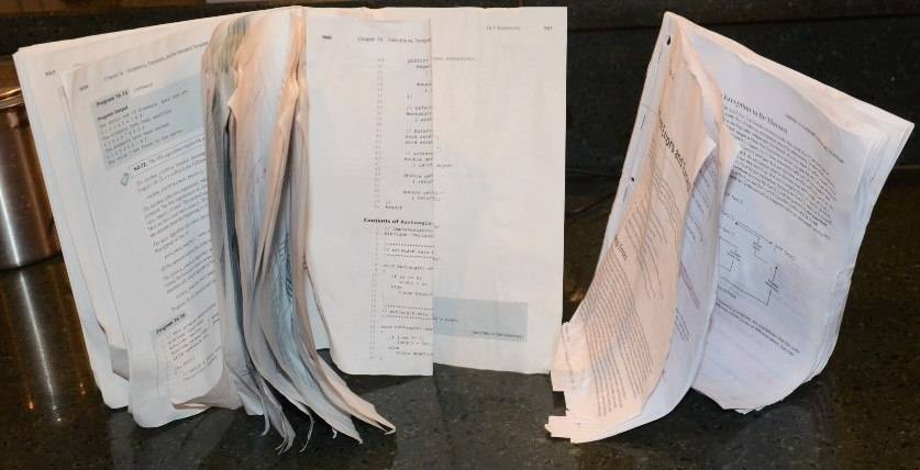

PS: Sorry the copy looks so awful, it is still drying and all wrinkled.
Look at my poor books, one chapter is cpt16 of Gaddis, the other is cpt 15 of Ivor.
