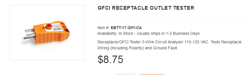

Definitely, which is why the inexpensive outlet tester that I mentioned is important to get and use on all of our outlets...
berkeman said:
Do you have an outlet tester with GFCI test capability? They are inexpensive, and very handy for debugging problems like this.
https://www.electricalbasics.com/electrical-testers/receptacle-outlet-gfci-tester
Product listing for a GFCI receptacle outlet tester, showing an orange plug-in tester with a red test button and indicator lights, priced at $8.75.

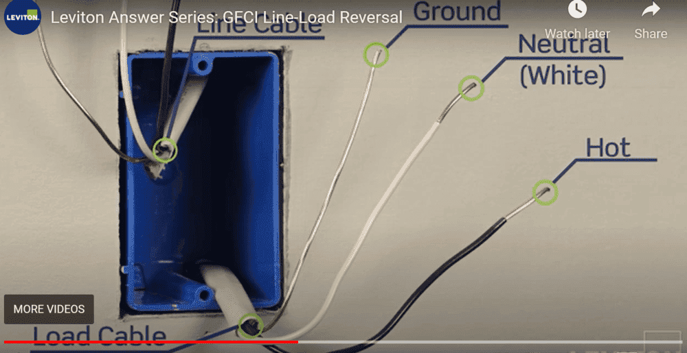

I have been thinking: the GFCI outlet has two hot connections (top hot is for the hot line, bottom is hot load) and two neutral connections (top is return line, bottom is return load). I connected the black wires and white wires the way they were connected on the GFCI that I replaced...
However, is it possible that the new GFCI outlet is not working because of line-load reversal: the black line hot wire may be connected to the GFCI hot load connection instead of to the GFCI line hot connection?
Same for the load lines: maybe the load return is connected to the the GFCI line return connection and the line return is connected to the GFCI load return...
Is the line cable always on the left and the load cable always on the right on the inside of the receptacle like in the figure below? MY receptacle looks like that with a cable on lower left and a cable on the lower right...
Diagram of a GFCI receptacle wiring in a blue electrical box, labeled Line Cable and Load Cable, with Ground, Neutral (White) and Hot wires marked.
How can I verify that line-load reversal is not happening using a voltmeter? I guess I can check the voltage between the hot and neutral for each cable with the breaker on and no GFCI outlet connected to identify the load and line cables...
It is typically marked on the GFCI. With the breaker on, do you get 120 VAC across one cable wire (black to white)? Then put those in the "toward box" (or whatever it says) connection and you should be good to go.
Thanks!
Yes, the back of GFCI has line connections (lugs) on top and load on bottom. Will get voltmeter tomorrow to make the measurement between hot line and return line. If I get 120VAC, that is the line.
The GFCI outlet currently has a permanent small yellow light turned On and pressing set/reset button does nothing and does not engage...

Update. Problem solved :)
I got a non contact voltage tester and identified the live hot wire from the hot load wire. I realized I did a line-load reversal. So all works just fine now.

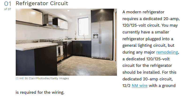

Glad that you are back up and running. :smile:
Do you still think that the same breaker controls the refridgerator and those outlets? At some point (home remodeling, inspection before the sale of the house, etc.), you may need to have that fixed:
https://www.thespruce.com/kitchen-wiring-circuits-1152911
Kitchen with dark lower cabinets, light countertops, a range with a stainless hood, and a stainless side-by-side refrigerator with an ice dispenser against the back wall.
EDIT/ADD -- Now I'm seeing some indications that it may not be an NEC requirement, maybe just a regional requirement. You can call your local city inspection department to ask.
My understanding is yes: the same breaker controls the refrigerator (upstream of the GFCI) and the GFCI which controls the other two regular outlets. With the GFCI out, the refrigerator kept working but GFCI and the other two outlets didn't.

If you are this uncertain about what you are doing you should not be touching any wiring, call in a professional.
