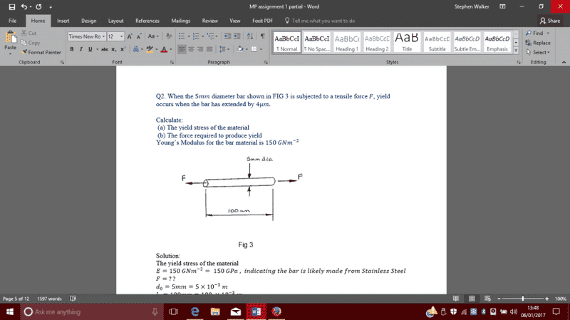

Determining yield stress via a bar subjected to tensile force
The discussion revolves around determining yield stress through calculations involving a bar subjected to tensile force. Participants engage in clarifying the appropriate area to use for calculations, unit conversions, and the correct application of stress and force units.

Al_Pa_Cone
143
All Equations Below
[/B]
You are using the wrong area for the cylinder. What should it be?
Do I use the area of a circle as the force is acting on the circular end? pi r^2

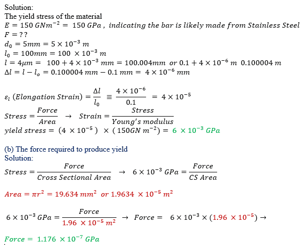

Of course. The force is equal to the stress times the cross sectional area.
Does This look better?
Once again, 1 m2 is NOT 1000 mm2! And GN m is not a unit of force.
I should have noticed that given the fact I only did it last week! As for the units, I think GPa is the correct unit to use in my answer? I am getting mixed up by force measured in Newtons and Newton meters as a measurment. I have reworked my answer again?
Looks OK, except for the units. GPa is a unit of stress, not force. It would be better to just give the answer in N.
That would be 117.6 Pascals then.
Thanks!
No it wouldn't. You have a stress in GPa and you multiply it by an area in m2. What are the units of the answer?
I only caught half of it in my emails (Looks OK, except for the units. GPa) and assumed it was ok.

As the calculations go I presume they are ok so my attempted answer is:
Much better.
You don't "choose to drop the distance/area measurement", as if this was optional. It disappears as a result of being multiplied by a distance/area measurement. N m-2 * m2 = N.
Remember, quantity equals number plus unit. Until you get the hang of this I would strongly advise you to write your units in your calculations, e.g.
Force = 6 x 10-3 GN m-2 * 1.96 x 10-5 m2 = 1.176 x 10-7 GN
