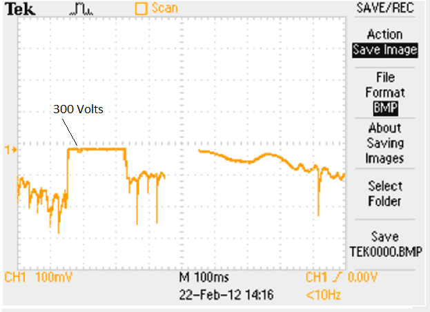

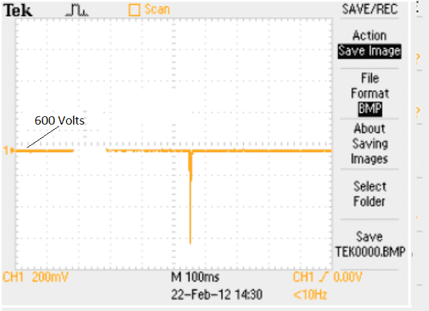

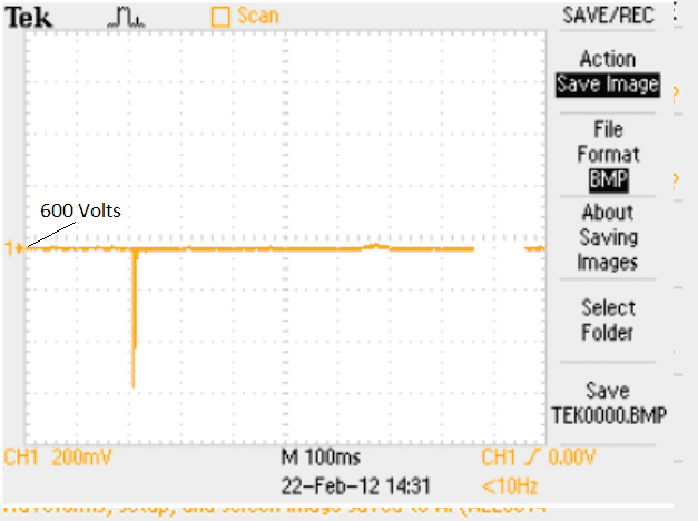

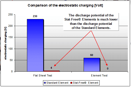

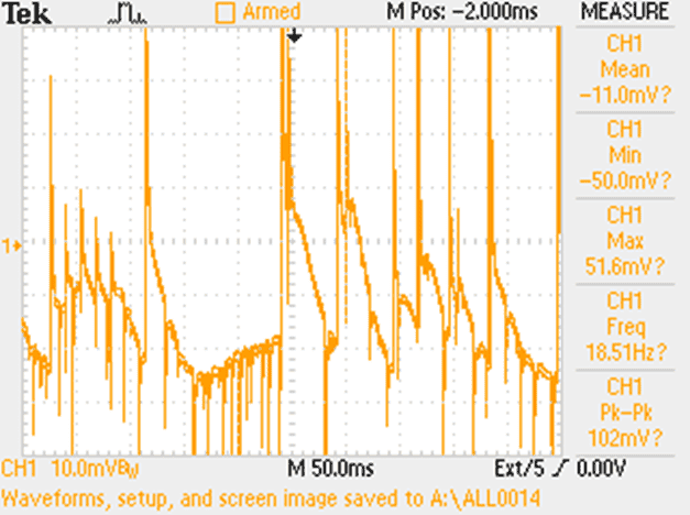

Here are some graphs that I've taken from a presentation we've done in a seminar to several large companies.
These were measured using a stat stick in a normal non "stat-free" element.
