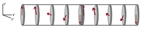

  • #92
Great to hear from you again OP! As you can see you've come up with a pretty tough paradox here.
AVentura said:
If the helix had a minimum width tangentially this width would look wider in the frame where it is translating (slower angular velocity but same radius). This would move the center of energy back towards the original axis. Just brainstorming.
I'm not picturing this; can you describe it in more detail?

Let's say in S an observer has a rotating cylinder that is translating along its axis. An observer traveling alongside it in S' sees a faster angular velocity and therefore length contraction tangentially, and it's twisted. Does he actually see a helix, saving him from Ehrenfest's paradox?

Now for the case of the helix. Here the only difference from the above is that ##\phi##, instead of being an independent variable labeling worldlines, is equal to ##k z##, where ##k## is the "spatial turn frequency" of the helix (this is related to the pitch, but I'm not sure if it's identical, and that detail doesn't affect what follows). Since we have that the helix does one full turn in length ##Z##, we have that ##k = 2 \pi / Z##, so ##\phi = 2 \pi z / Z##. So now, to find the total angular momentum of the helix, we have only a single integral, over ##z##, but the function of ##z## we are integrating over is more complicated since it includes trig function terms, and they won't all vanish this time.
Let's look at the functions of ##z## we end up with and how they integrate. For ##M^{01}##, there is no change from before: we still have ##z## integrated over ##- Z / 2## to ##Z / 2##, which gives zero. Note that the reason for this is that ##z## is an odd function and is being integrated over an even domain. So we can focus only on the components that are even functions of ##z##; there are three, ##M^{02}##, ##M^{12}##, and ##M^{23}## (which is unchanged from before).
So we need to evaluate two new integrals (plus we have one unchanged from before):
M_{\text{total}}^{02} = - \gamma R \int_{-Z/2}^{Z/2} \cos ( \frac{2 \pi z}{Z} ) = - \gamma R \frac{Z}{2 \pi} \left[ \sin ( \frac{2 \pi z}{Z} ) \right]_{-Z/2}^{Z/2} = 0
M_{\text{total}}^{12} = - \gamma \omega R \int z \sin ( \frac{2 \pi z}{Z} ) = - \gamma \omega R \left[ - \frac{Z}{2 \pi} z \cos ( \frac{2 \pi z}{Z} ) + \frac{Z^2}{4 \pi^2} \sin ( \frac{2 \pi z}{Z} ) \right]_{-Z/2}^{Z/2} = - \gamma \omega R \frac{Z^2}{\pi}
M_{\text{total}}^{23} = \gamma \omega R^2 Z
This is telling us two things. First, since ##M^{02}## vanishes, we don't have a "mass moment" in this frame, which is good because in this frame the cylinder is not translating, only rotating, and a nonzero "mass moment" would imply translation. Second, since ##M^{12}## does not vanish, the angular momentum is not solely in the x-y plane; it is partly in the x-z plane as well, at least at time ##t = 0##. In other words, the plane of the angular momentum is not perpendicular to the axis of rotation.
In other words, the above analysis appears to be saying that the helix motion, considered dynamically, should not be a free motion, since the plane of its angular momentum is not perpendicular to the axis of rotation. If a helix were started with the assumed 4-velocity field, but no further external forces were applied, what should happen is that the axis of rotation should precess (so the 4-velocity field we assumed would not be valid after ##t = 0##). Alternatively, in order to maintain the assumed 4-velocity field over time, external forces would have to be applied to change the angular momentum vector in the right way with time in order to keep the axis of rotation constant. (If we evaluate the above integrals for arbitrary ##t##, we will see that indeed the plane of the angular momentum changes--in general it has components in both the x-z and y-z planes, as well as the x-y plane.)

  • #105
Is the problem with n=1 just that there is nowhere on the helix to place the needed counterweights (using positive mass)?
Visual, for z<0 you can only put the weight on one side (say top). For z>0 you can only put on the bottom. With more curls you can put one on any side you want, then find the needed weight.
