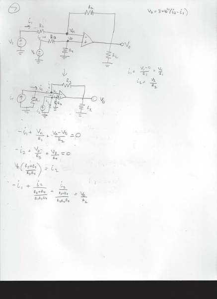

Design a circuit containing a single op amp that can perform the following operation: Vo = 3*10^4(i2-i1), where i2 and i1 are input current sources
Where I'm at right now, I am just using the equation for a difference amplifier gains, but I have more unknowns than equations, so I don't know what to do.

Your diagram labeling does not agree with your equations.
Big hint: since the inputs are current you need a total of only 2 resistors.
Oh I see, I need to change the label of R2 and R3. Either way my problem persists. The equation should be correct now with that change, as well as making it R3*i2 in my second stop

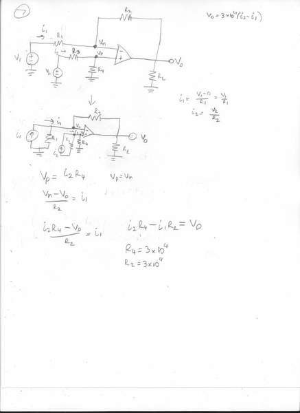

Okay, I source transformed, corrected the labeling, and this is what I came up with.

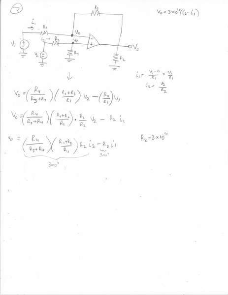

Edit: my bad, I was saying that no current goes through R1 and R3, which can't be possible since there is a potential difference between Vn/Vp and the resistors. Now the equations are even messier. Where do you get the fact that I only need 2 resistors from? I am following the template for a difference amplifier as given in the textbook and I redrew as my original image, pre-source transform

See if you can get it to work without R1 and R3.
And RL.
