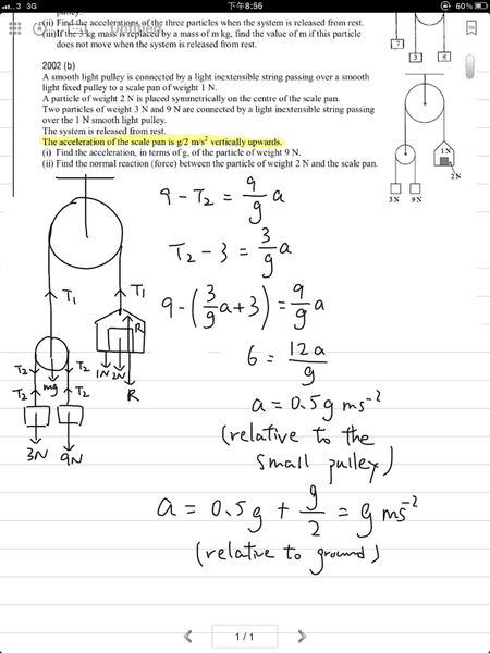

for part(i) the answer is g/4 + g/2 = 3g/4 ms^-2
how to calculate the acceleration of the 9N blcok relative to the small pulley to be g/4??
Did I miss something?
how to calculate the acceleration of the 9N block relative to the small pulley to be g/4??
thank you so much!o:)
The small pulley has rotational inertia. Therefore, the tension on the string supporting the 3N particle is different than tension on the string supporting the 9N particle.
