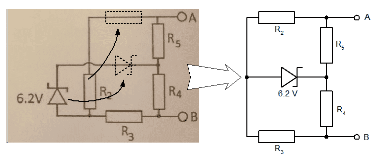

Hi nathsen. A zener diode provides a nearly constant potential drop across itself so long as it conducts a current greater than its threshold value (it varies from device to device, but generally just a few mA are required to put it into its normal operating conditions). When its operating in this region it behaves much like a fixed voltage source with a pretty low internal resistance (usually below 20 Ohms and typically in the single digits).
You should see if you can find a V-I curve for a zener to take a look at so that you can get a feel for what it does.
For your purposes treat it like a 6.2 V DC voltage source. It's resistance will be much smaller than all the other resistances in the circuit so its a good bet that it can be ignored.
R1 and the actual voltage source are ignored because they can't be "seen" behind the zener's fixed potential and low resistance.

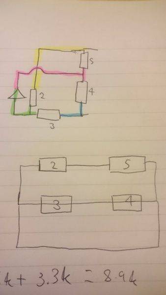

Thanks very much for your reply. I've tried to follow your advice (see picture). Is that correct in theory? I am still not getting the value desired but is it through other means rather than how I'm simplifying the circuit!?

Remember that when the voltage source is suppressed it is replaced by a short circuit (wire). So your pink and green nodes should become all one color.
Ok so I've gone over the green with pink. Now I need to identify components connected to "same pair of colours". So actually Resistor 3 and 4 are both connected to pink and blue which means they are in parallel. And 2 and 5 are also in parallel? Sorry I'm getting a mental block over this!
Sometimes redrawing the circuit in a slightly different way can yield insights; you pick up relationships that you missed before.
If you move R2 and the zener to different locations in the same wire (so no topological changes) as shown below, then you should be able to see that the circuit on the left can be morphed into the circuit on the right:
If you then suppress the zener as you would a voltage source, what do you get for the Thevenin resistance of the network?
