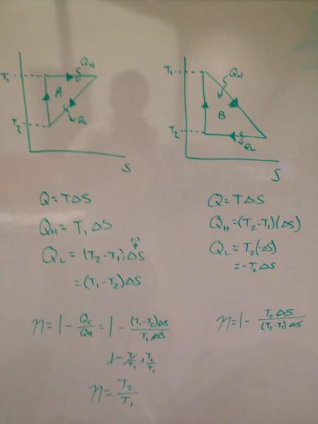

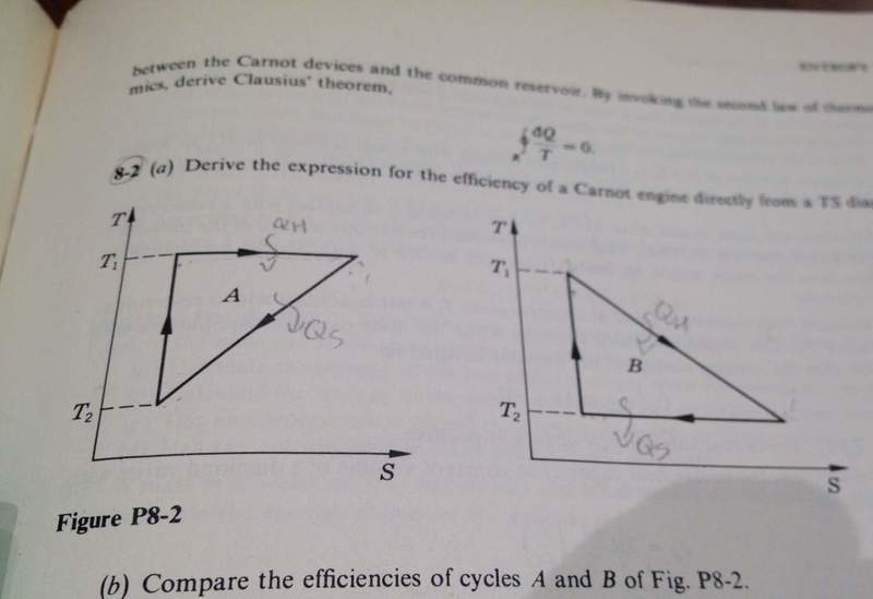

Part B
Thermodynamics, Carnot cycle, ts diagram
I understand that for figure A, Qh=T1Δs and Qc=(T1-T2)Δs once you take the negative out of the Δs. For figure B, Qh=(T2-T1)Δs and Qc=-T2Δs once you take the negative out of the Δs. For the efficiency of figure A, I got η=T2/T1 after plugging into 1-Qc/Qh. For figure B, I got η=(2T2-T1)/(T2-T1). I have a feeling that what I have for figure A is right but that B is no where close. Any help would be awesome

Keep in mind that efficiency is given by:
η = W/Qh
and W = Qh-Qc.
What is W and Qh in terms of the areas under these graphs? Hint: What is the area under a sloping line?
Is there a difference between A and B in terms of W? How about in terms of Qh?
