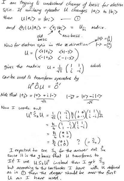

I am struggling to understand spin transformations and have used Sakurai's method of
|new basis> = U |old basis> to change basis vectors and hence should have
Sz' = Udagger Sz U
to transform the operator. I thought this should give Sz' = Sy in the workings (see attachment) but it gives Sx instead. If I use
Sz' = U Sz Udagger then I do get Sz'=Sy but according to the texts I have, the first arrangement is the correct form. So I'm really confused. Can anyone see what I'm doing wrong here.
I would be really grateful for any help with this. Thank you

You're not doing anything wrong. Your expectations are just not correct. Both
\frac{\hbar}{2}\begin{pmatrix} 1 & 0 \\ 0 & -1 \end{pmatrix}
and
U^\dagger \left[\frac{\hbar}{2}\begin{pmatrix} 1 & 0 \\ 0 & -1 \end{pmatrix}\right] U = \frac{\hbar}{2}\begin{pmatrix} 0 & 1 \\ 1 & 0 \end{pmatrix}
represent the same operator, Sz, but in two different bases.
I'm guessing what you were thinking corresponds to
U^\dagger \left[\frac{\hbar}{2}\begin{pmatrix} 0 & -i \\ i & 0 \end{pmatrix}\right] U = \frac{\hbar}{2}\begin{pmatrix} 1 & 0 \\ 0 & -1 \end{pmatrix}
In the new basis, Sy is represented by the same diagonal matrix that represents Sz in the old basis.
Note that if U takes you from the z basis to the y basis, U goes the other way, from y to z. The matrix
represents Sy in the y basis, so in the z basis, its matrix is given by
U \left[\frac{\hbar}{2}\begin{pmatrix} 1 & 0 \\ 0 & -1 \end{pmatrix}\right] U^\dagger = \frac{\hbar}{2}\begin{pmatrix} 0 & -i \\ i & 0 \end{pmatrix}
which is what you would expect.

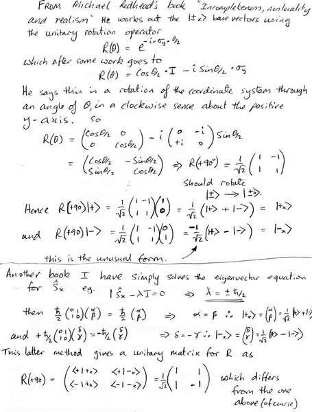

Oh bother! yes, sorry. It should read
Some books give |+x> = 1/sqrt2(|+> + |->)
|-x> = 1/sqrt2(|+> - |->)
Others give |+x> = 1/sqrt2(|+> + |->)
|-x> = -1/sqrt2(|+> - |->)
I have included an image of the workings I made for how the two different forms for the |-x> base vector arise. Not sure how to check which one is consistent with stuff I haven't yet got to. How do people normally construct the U matrix to rotate bases in practice - is it like I did in the attachment on my first post?
Many kind thanks for any help given
