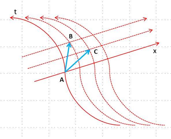

I found this interesting old thread. As far as I understand, as long as an origin is fixed in the affine space, each point maps to an unique vector (namely the position vector). So we get a position vector field defined at all points in the affine space.
Now pick for instance polar coordinates having ##r=0## at the chosen origin point O. At point P with polar coordinates ##(r,\theta)## the position vector field is well defined and its value is ##r\partial_r## in the given coordinate chart. However it lacks of a straightforward interpretation when compared w.r.t cartesian coordinates for the same case.
As @stevendaryl pointed out we cannot basically interpret ##(r,\theta)## as an instruction: move of ##r## units in r-direction starting from the chosen origin.
