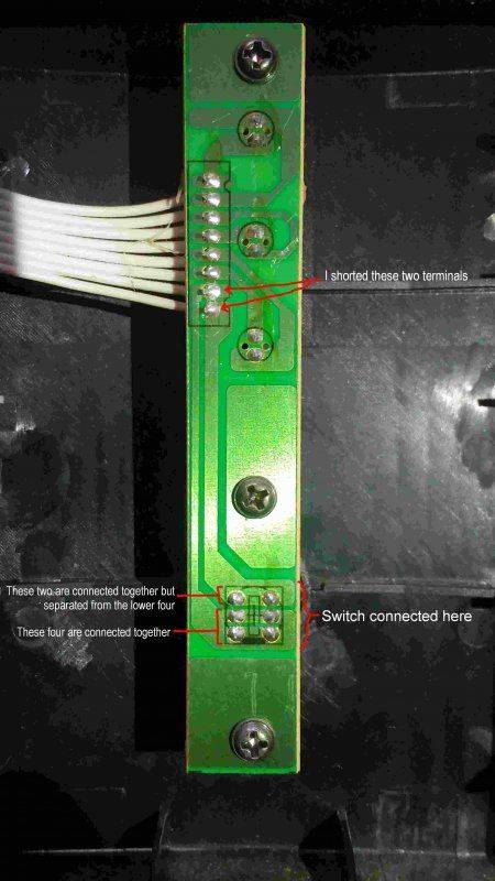

I conducted a few tests today.
1. Check connectivity across wires. Result: No defects found.
2. I plugged in the UPS.
The procedure to switch on the gadget is to hold the switch in "on" position for a few seconds after which there will a beep and the lights will glow. Did that but it didn't switch on. Then I discovered that there was no connection across the terminals of the switch even when I pressed it, which meant that the switch was faulty. No issue. I used a screw-driver to directly short the terminals. Still no success.
The multimeter read 26mV DC across the terminals of the switch, which meant that the circuit was receiving power from the mains.
In this condition, I measured the voltage across the wires from the PCB that were supposed to be connected to the battery (see picture in OP). The reading was 26-27 mV DC.
What I am guessing is, the circuit is "searching" for the battery, and on finding that there is no battery, it is not allowing itself to be switched on. Perhaps this is one of those newer designs that @hutchphd and @scottdave have mentioned above.
I conducted these tests before reading @Borek's post, so I have no idea if I have screwed something up. Anyway, I have nothing to do now. At this moment I can't use a car battery for the experiment. Once the lockdown is over, I will buy a new battery and test with it.

I'm glad that you are still here to give us a report, after the screwdriver test, @Wrichik Basu
One thing I thought of - I think some models may have a circuit breaker with a "reset button". Does yours have that? I think you should find a battery to hook up to it. Maybe a car battery, if you can find one.
Ace Hardware carries some sizes of the UPS 12 volt batteries in my town. Also there is one of those Batteries+Bulbs nearby my home. They can dispose of your old battery - don't throw it in the garbage as it contains lead.
I was thinking that "please be careful" was referring to the "screwdriver as a switch" action @sysprog
Actually I have been through worse. Was a bit shaky before doing this, but necessary precautions were taken.
Following is a picture of the PCB on which the switch is connected:
Out of six terminals, four are internally connected; the remaining two are connected within themselves but not with the other four. It is evident that the switch is supposed to establish the connection between these two sets. On checking with my multimeter, I found that this connection was not being established. So I shorted the set of four with the set of two using a screw-driver at the point shown in the picture.
