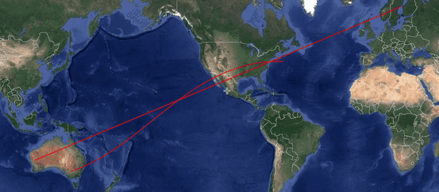

The story starts with a discussion about the four aviators that had disappeared. It is stated that they disappeared over Baja California, Sweden, Long Island, and Australia. The protagonist concludes that these lie on a Great Circle, a circle with the same circumference as the equator. From this, he concludes that this is consistent with the planes getting swept up by the satellite. I used a website called scribblemaps.com to draw Great Circles on a map…it’s pretty hard to get them to go through the points you want. While I could get a straight line (on a rectangular projection) through the four locations of interest (Australia being big enough to give some leeway), I was unable to get a Great Circle to Sweden.
world map
Trying to draw a great circle (curved) that goes between Australia, Baja California, Long Island, and Sweden.

    If we assume a retrograde orbit, and taking into account that the Earth is rotating under the orbit, I can get a trajectory that passes over Sweden and just skims Australia with a 6 hour orbital period. However that same orbit does not pass over California or Long island.
    With a 6 hr orbit, it will return to being over any given point of the surface every four orbits. So we can look to see if it might pass over these two points in one of the other three orbits. Alas, such is not the case. the only orbit that crosses over the US goes from the SE coast to crossing the Canada border somewhere around Montana and N. Dakota.
