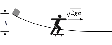

A small block is released from rest at the top of a frictionless non-planar incline. It slides down left to right until it reaches a horizontal surface and coasts to the right thereafter. Neglecting air resistance, find the final speed of the block at the bottom of the incline given the vertical drop h.
Solution
We use mechanical energy conservation between two points, the top and the bottom of the incline. We assume that zero gravitational is at the bottom of the incline.
At the top:  ##K_i = 0;  U_i = mgh##.    At the bottom:  ## K_f = \frac{1}{2}mv^2;  U_f = 0##.
By conservation of mechanical energy, ##\Delta K +\Delta U=0##.  Then,
$$ \left(  \frac{1}{2}mv^2-0 \right)+(0-mgh)=0 \rightarrow v=\sqrt{2gh}  $$.

Now consider the reference frame of a skateboarder who is moving to the right with speed ##u= \sqrt{2gh}##.  Redo the problem in the skateboarder’s frame of reference to find the block’s initial speed, v0, given the vertical drop h.
We note that at the bottom of the incline the block is at rest in the skateboarder’s (primed) frame and conserve mechanical energy once more.
At the top:  ##K’_i = \frac{1}{2}m(-v_0)^2;  U’_i = mgh##.    At the bottom:  ## K’_f = 0;  U’_f = 0##.
By conservation of mechanical energy, ##\Delta K’ +\Delta U’=0##.  Then,
$$ \left( 0- \frac{1}{2}mv_0^2 \right)+(0-mgh)=0   $$
$$ – \frac{1}{2}mv_0^2 -mgh=0   \rightarrow ???  $$
We have reached the impossibility of having, on the left-hand side, the sum of two negative numbers that must be zero according to the right-hand side.  Something is amiss.  At this point I ask you, the reader, to please pause, consider your reaction to what you just read, answer the three-choice question below and continue reading if you wish.

A savvy skateboarder would realize that mechanical energy (ME) is not conserved in the moving frame.  In the lab frame, the normal force is always perpendicular to the block’s displacement and does zero work on the block.  In the skateboarder frame, the path of the block is no longer perpendicular to the normal force.
In fact, the skateboarder sees the block’s speed start at some initial non-zero value and then drop to zero and remain zero as if a dissipative force stopped it. Therefore, ME is not conserved in the moving frame and 1 is the correct answer.
Instead of ME conservation, the skateboarder would be well advised to use the work-energy theorem and take into account the work done by the normal force.
OK, but if you were the skateboarder, how would you calculate this work considering the arbitrary curvature of the incline? The answer is by transforming to the lab frame in which the normal force does no work. Let primes denote quantities in the moving frame. Using ##\vec{u}## as the relative velocity between the two frames, we have ##\vec{r}’=\vec{r}-\vec{u}~t##.  Then ##d \vec{r}’=d\vec{r}-\vec{u}~dt##.  The work done by any force in the primed frame is
$$W’=\int \vec{F} \cdot d \vec{r}’ =\int \vec{F} \cdot (d \vec{r} -\vec{u}~dt)=\int \vec{F} \cdot d \vec{r} -\vec{u} \cdot \int \vec{F}~dt$$
The first term in the right is the work done by the force in the unprimed frame while the second term is ##-\vec{u} \cdot \vec{J} ## where ##\vec{J}## is the frame-independent impulse delivered to the system. Thus, the work done by the normal force in the primed frame is,
$${W’}_N=W_N-\vec{u} \cdot \vec{J}=W_N-m\vec{u} \cdot \Delta \vec{v}’ $$
In this case, ##W_N## is zero. The skateboarder sees the incline move with constant velocity ##-\vec{u}## and, since the block is initially at rest relative to the incline, the skateboarder deduces that ## \vec{u}=v_0 \hat{x}##.   Furthermore, according to the skateboarder  ##\Delta \vec{v}’=+v_0 \hat{x}## because the block is initially moving to the left with speed ##v_0## and finally comes to rest.  Thus,
$${W’}_N=-m (v_0 \hat{x}) \cdot \left(  v_0 \hat{x} \right) =-mv_0^2$$
According to the work-energy theorem
$$\Delta (ME’)={W’}_N$$
We already have the left side of the equation from the earlier attempt to solve this in the primed frame.  Thus,
$$ – \frac{1}{2}mv_0^2 -mgh=-mv_0^2 $$
From this, it is easy to show that ##v_0=\sqrt{2gh}##.
A second opinion
The skateboarder can sidestep the question of how to account for the work done by the normal force in the primed frame by using combined conservation of mechanical energy and linear momentum.  Consider a two-component system with component A of mass ##m_A## being the block and component B with mass ##m_B## the Earth + incline. In this case, mechanical energy is indeed conserved because the work done by the incline on the block is the negative of the work done by the block on the incline while there is no friction to dissipate energy. In the primed frame, both systems are initially moving to the left with speed ##v_0##.  When the block reaches the bottom of the incline, it is at rest while Earth + incline are moving to the left with speed ##v’_f##.  We have then
$$-m_Av_0-m_Bv_0=0-m_Bv’_f$$
$$m_Agh+\frac{1}{2}(m_A+m_B)v_0^2=\frac {1}{2}m_B{v’}_f^2$$
This is a system of two equations and two unknowns that is solved to give
$$ v_0=\sqrt{ \frac{2gh}{1+m_A/m_B}};~~~v’_f=\sqrt{2(1+m_A/m_B)gh}$$
When  ##m_A/m_B <<1##, to a very good approximation, ## v_0 = v’_f = \sqrt{2gh}## which is consistent with the results in the previous section.  It should be clear to the reader that in either reference frame momentum and energy conservation gives the exact solution while energy conservation only results in an approximation, albeit a good one.
