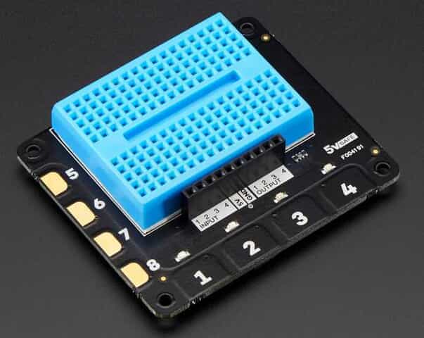

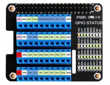

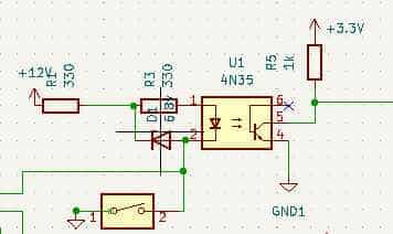

A major reason for switching to direct GPIO pin control (rather than Explorer Hat inputs and outputs) was that the double-swing gates required a total of 5 input pins (remote + 4 limit switches) and 4 output pins (2 for the forward motor coils and 2 for the reverse motor coils).  Additionally the use of multiple input pins made it somewhat impractical to implement opto-isolation by way of discrete components so a relatively cheap 8-channel opto-isolator  was procured. The graphic below shows a 4-channel version since this was the clearest image available.
A feature of this device is that the opto-isolated outputs have two terminals: one for ground and the other signal output which has a built-in 3.3K ohm current-limiting resistor running from the photo-transistor emitter to the signal output terminal (ie no direct access to the emitter). Pullup resistors (connected between signal output and the raspberry pi’s 3.3 V source pin) therefore needed to be in the order of 20K ohms so that the potential divider circuit formed by the pullup resistor and 3.3K  ohm current-limiting resistor would still guarantee a ‘LOW’ state when the opto-isolator’s photo-transistor was on. The opto-isolator’s design notes recommended the use of micro-controller internal pullup resistors (about 60K ohms on the raspberry pi) but some research on these revealed hardware issues – avoided by the use of external pullups.
Whilst electro-magnetic interference (EMI) arising from stopping and starting of induction motors was successfully dealt with by blocking delays as described in the next section , randomly generated EMI still resulted in false activation of relays. Since this EMI  typically has high frequency components, it can be dealt with by capacitors (+- 100 nF)  placed between the opto-isolators’ signal output and ground. The capacitor , combined with the above-mentioned resistors, effectively creates an RC filter circuit.

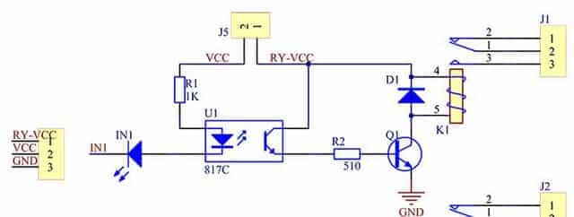

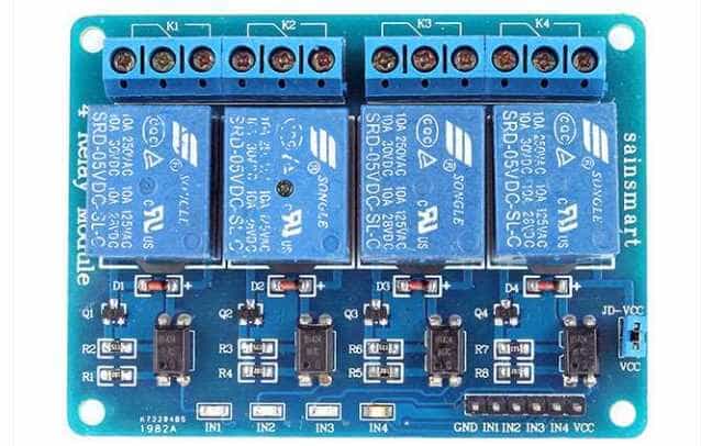

Driving 5V Sainsmart Relay inputs from 3.3V logic
When driving opto-isolated Sainsmart relays the required supply voltage is 5 Volts both for the LED input side and for the photo-transistor driven relay control inputs.  The two supply points are linked by a jumper which can be removed if complete opto-isolation is required. In this case one would need a separate 5 Volt supply for the relays themselves (as distinct from the raspberry pi’s  5V supply pin). For this application the jumper was retained in place and VCC for the Sainsmart relay set was connected to the raspberry pi’s 5V supply pin. It is normally unsafe to connect 3.3V logic pins to a point which could be at a potential of 5V but Internet searches on this problem pointed out that between VCC and any of the relay input pins , there is a 1K ohm resistor and two LEDs : the photo-diode for the opto-isolator and an indicator LED as shown in the following circuit diagram:
This means that between VCC and any input pin there should always be a voltage drop corresponding to the summed forward bias voltages of both LEDs. So the raspberry pi GPIO pins will never ‘see’ a potentially damaging 5V supply voltage. Put another way,  if the potential difference between a GPIO pin (in the HIGH state) and 5V is less than the sum of the diodes’ forward bias voltage drops, the diodes will not conduct and no damaging current can flow from the 5V supply into the GPIO pin. Strictly speaking, opto-isolation is sacrificed if the jumper connects VCC to Relay Supply VCC but there is still ‘air gap’ isolation from whatever current is carried by the relay circuits themselves.

When driving motors – with separate coils for forward and reverse motion – from a micro-controller, it is absolutely necessary to ensure that it is impossible to accidentally activate both forward and reverse at the same time. This objective was achieved by wiring the output relays for “electrical interlock”. Essentially the forward motor circuit is driven through a series circuit which contains its own relay’s normally open contacts as well as the ‘normally closed’ contacts for the paired reverse motor circuit. And vice versa for the reverse motor circuit. If both motors are activated at the same time, both ‘normally closed’ contacts will be pulled open  and neither motor will be activated. A detailed explanation of electrical interlock can be viewed by clicking the link.
Whilst the Sainsmart 4-channel relay set is rated for 10 amp AC current and the gate motors only need 2 amps, it was found that in practice these relays did not function reliably – perhaps because of the typically high starting currents drawn by induction motors. Therefore the motors were instead driven by electrical contactors with 220 volt control inputs provided via the Sainsmart relay set. The contactor control inputs are  relatively light AC electrical loads for the Sainsmart relays and (once they were in place) , there were no further problems with gates failing to operate as commanded from within the gate control program.
