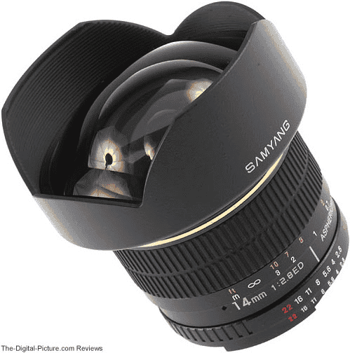

      my goto UW angle lens is my Samyang 14mm, f2.8
      I have been quite pleased with it's quality considering its affordable ~ AU$360 price tag
      particularly on wide angle astrophotography where pinpoint light sources from stars gives a good test
