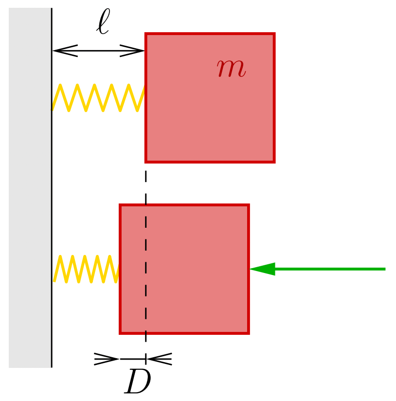

Setup
A mass ##m## has an ideal spring of length ##ell## and spring constant ##k## attached to it. The mass and spring are pressed against a fixed wall such that the spring is compressed by a distance ##D##, see the figure below.
spring of length
A mass ##m## is attached to a spring of length ##ell## next to a wall. When pressed towards the wall, the spring compresses by a distance ##D##.
Model and assumptions
In other words, the mass of the spring is zero, and the force at its ends is given by Hooke’s law. All of this occurs in a horizontal plane, meaning that we do not need to deal with gravity.
Release and the wall’s work
Once released, the spring pushes the mass away from the wall. Similar to the jump off the ground, the wall provides no work. By the same reasoning as in our example argument, the mass cannot move away from the wall.

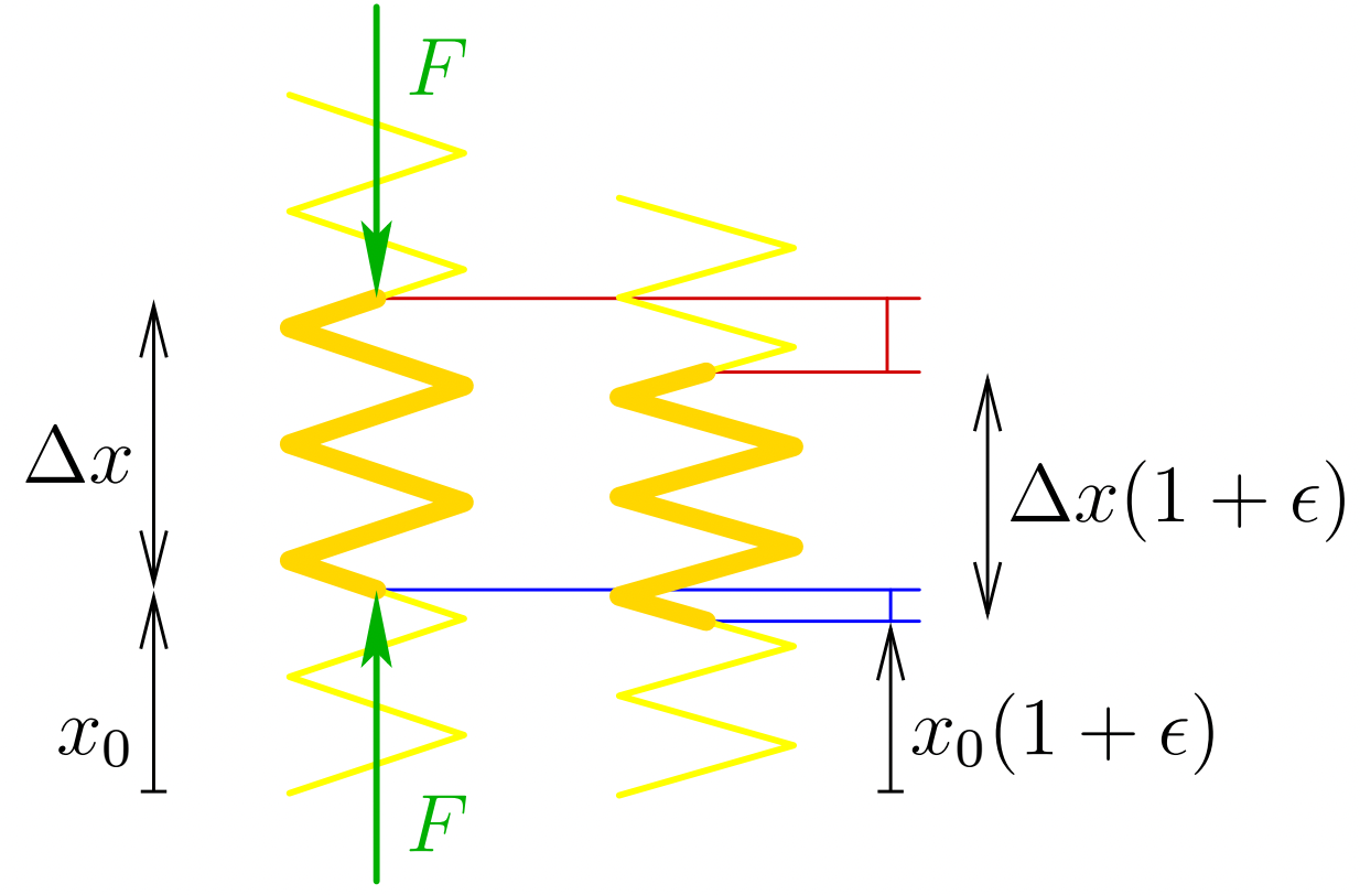

Work on a spring segment
compress a spring segment
To compress a spring segment ##Delta x##, forces equal in magnitude but opposite in direction act on both ends. The displacement at the top of the segment (red) is larger than that at the bottom (blue). Therefore, the upper force does positive work of a larger magnitude than the negative work of the lower force.
Changing the strain by ##depsilon##, the lower end of the string segment moves by ##x_0 depsilon## and the upper by ##(x_0+Delta x)depsilon##. The total work done on the segment becomes $$dW = F x_0 depsilon – F (x_0+Delta x) depsilon = kappa epsilon Delta x , depsilon.$$ Integrating this from no strain to a strain ##epsilon_0## leads to $$W = kappa Delta xint_0^{epsilon_0} epsilon,depsilon = frac{kappaepsilon_0^2}{2} Delta x.$$ This is the total energy stored in the spring segment at strain ##epsilon_0##.

    If the spring is not attached to the wall, there is no external force to the spring+mass system so its momentum is conserved.
    It does not need to be physically fixed to the wall to compress the spring.
    Log in to Reply
  12. Orodruin
    Orodruin says:
    May 31, 2022 at 4:53 am
    Wouldn’t the explanation be simpler with a spring that is not attached to the wall (so no oscillation)?
    The spring is not attached to the wall for this very reason. I might have made it clearer in the first image though. Also note that I have been careful to only discuss the launch up to the time when the spring is back to its unloaded length.
    Log in to Reply
  13. Delta2
    Delta2 says:
    May 31, 2022 at 4:52 am
    The spring is not being de-coupled from the wall entirely. It is still prevented from interpenetrating. It can push. But it is detached so that it cannot pull. It is not glued, nailed, screwed or otherwise fastened down.
    Ok I see it can push but not pull, in that case momentum is not conserved and yes we will not have oscillation.

    You start with a horizontal spring but in the analysis you refer to “lower end” and energy flowing upward. It may be confusing.
    I’ll add ”in the figure”
