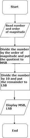

I’ll give an example of an algorithm represented by i) Natural language in steps, ii) a Flowchart.
Example 1
Problem: A number and its order of magnitude are given via the keyboard of a computer. We are asked to write an algorithm that computes and displays the MSB and the LSB of the number.
Solution:  i)
  1.   Read an integer
  2.   Read the order of magnitude of the number
  3.   Divide the number by the order of magnitude and put the quotient to MSB
  4.   Divide the number by 10 and put the remainder to LSB
  5.   Display MSB and LSB
ii)
From the above example, we see that the representation of an algorithm in natural language with steps has the advantage of being very close to how we humans think but it is not so close to an implementation in a programming language as it is abstract enough for this. The situation is even worse in this regard if we use just natural language. Flow charts as ii) above use various shapes to state what each step represents i.e. use an oval shape for the start, rectangular shape for a process, parallelogram for the input/output of data, diamond(rhombus) for decision, etc. so they are more descriptive than natural language but they have not used so much anymore. For more on flowcharts see Wikipedia##^{[5]}##
