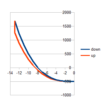

Q13 d) [2*]
Graph.
The illustration is wrong.
The graph should be curved even for an ideal trampoline. Indeed, whereas part c) concerned the force in the springs, which varies as y2, this part concerns the force on the trampolinist, and for small y that varies as y3.
Thus, the illustration should show two cubic curves, one above the other. They should meet at the origin, but not at the left-hand end.
Q13 d ii) [1*]
“Solution: There is a larger force upward when moving down than up, as then the kinetic energy will be lower after the bounce“
I can make no sense of the explanation. The force is less when moving up because of energy losses in the springs.
