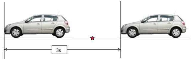

Measuring the interval from the front bumper to the front bumper
Front-bumper measurement
Measuring the interval from front bumper to front bumper
Figure 1. Two cars with a minimum interval
Figure 1 illustrates one way of measuring the time interval between cars. We have defined a “measuring point” on each car (here it is the front bumper) and measure the time interval between the front bumper of the first car passing an arbitrary point in the road to the following car passing the same point. Let us see what this measurement method implies.
Implications
  1. Since the minimum time interval between cars is 3 seconds, our measurement method implies that the maximum number of cars that can pass an arbitrary point on the road is one car every 3 seconds. One car every 3 seconds equals 20 cars every minute or 1200 cars every hour. The road capacity is therefore 1200 cars/hour
  2. Since the actual speed of the cars has not entered the calculations, we must conclude that the road capacity is independent of the speed limit. In other words: A local road with a speed limit of 50km/h has the same capacity as one lane on a highway with a speed limit of 100km/h.
  3. By the same reasoning, the maximum road capacity between two points depends only on the number of independent lanes, not on the speed limit. Thus, if one lane is blocked for some reason (accident, road work…) the road capacity is reduced accordingly.

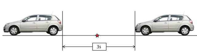

Measuring from back bumper to front bumper
Why change the method?
The measurement method given in Figure 1 has some serious problems at low speeds. One unintended consequence is that it assumes that all cars occupy the same space when they are standing still – which is of course impossible. To get better precision, we must modify our measurement method somewhat.
Improved measurement
Figure 2. A better measurement method
Figure 2 shows a better way of measuring the time interval between cars. Now we will measure the time interval from the rear bumper of the first car passing an arbitrary point in the road to the front bumper of the following car passing the same point. This method solves the low-speed problem, but it is harder to analyze.
