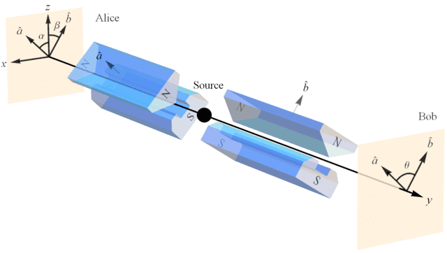

If Alice is making her spin measurement ##\sigma_1## in the ##\hat{a}## direction and Bob is making his spin measurement ##\sigma_2## in the ##\hat{b}## direction (Figure 1), we have
\begin{equation}
\begin{aligned}
&\sigma_1 = \hat{a}\cdot\vec{\sigma}=a_x\sigma_x + a_y\sigma_y + a_z\sigma_z \\
&\sigma_2 = \hat{b}\cdot\vec{\sigma}=b_x\sigma_x + b_y\sigma_y + b_z\sigma_z \\ \label{sigmas}
\end{aligned}
\end{equation}
Figure 1. Alice and Bob making spin measurements on a pair of spin-entangled particles with their SG magnets and detectors. In this particular case, the plane of conserved spin angular momentum is the x-z plane.
