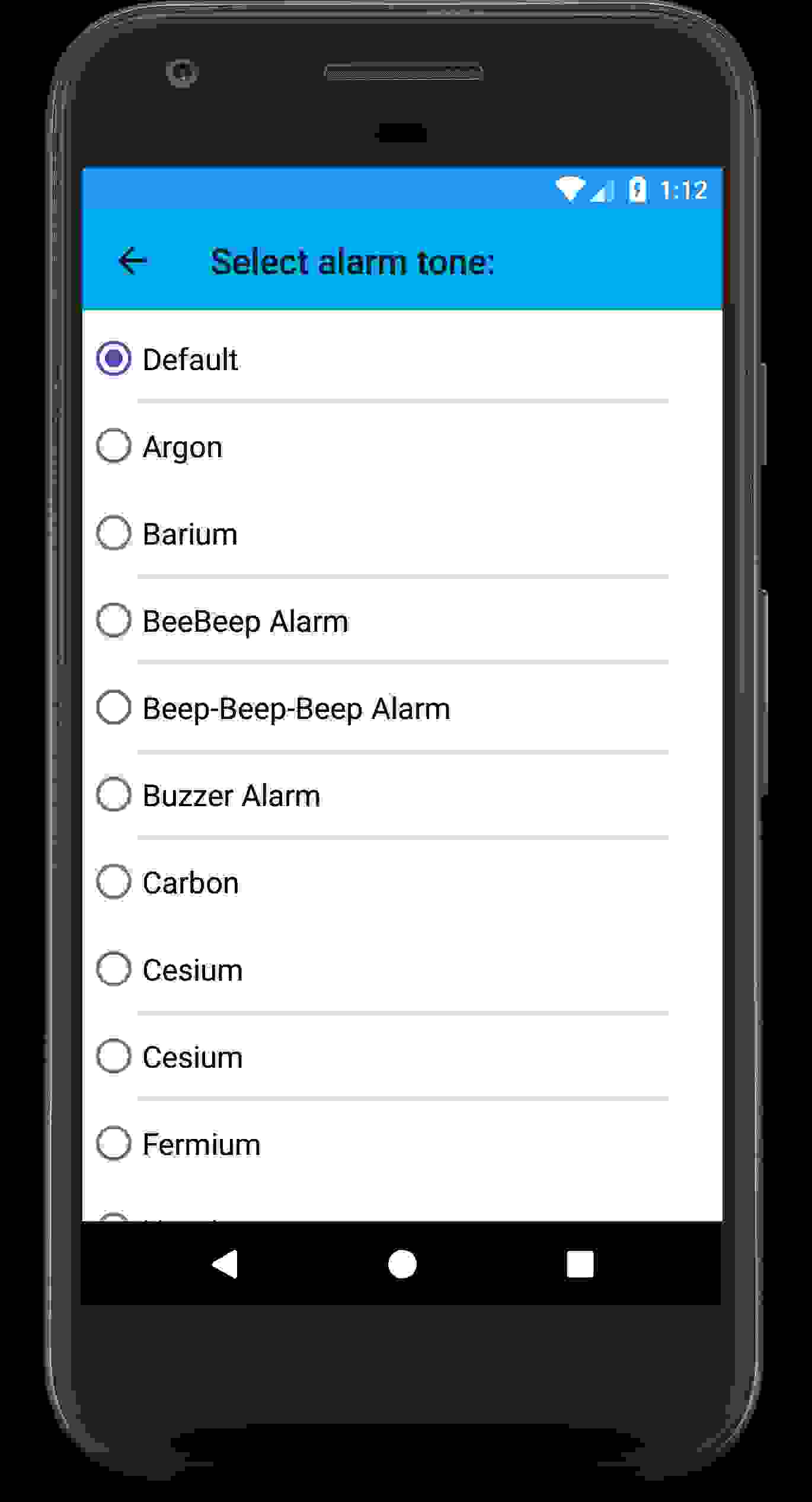

Building a ringtone picker activity:
Now, we shall design a simple ringtone picker activity. The activity will have a RadioButton for each tone. When the user presses the back key or the up button, the activity will return the picked Uri and finish itself. For simplicity, I will not list any import statements and assume that imports are managed by your IDE. I shall also assume that all the static members of RingtoneManager class have been imported using:
import static android.media.RingtoneManager.*;
Therefore, from now on, I will address all the static members of this class without using the class name.
Preview
At the end, the ringtone picker would look something like this:
ringtone_picker_activity
Without further ado, let’s start!

if (getIntent().hasExtra(EXTRA_RINGTONE_TYPE)) {
   type = (int) Objects.requireNonNull(getIntent().getExtras()).get(EXTRA_RINGTONE_TYPE);
} else {
   type = TYPE_ALL;
ringtoneManager.setType(type);
Now we can extract the list of tones using the getCursor() method of RingtoneManager class:
Cursor tonesCursor = ringtoneManager.getCursor();
In Android, the Cursor interface is used to access the result set returned by a database query. You can think of it as a table with several columns. Each column has a unique index (an integer), and the data of that column can be accessed using the column index.
The Cursor returned by RingtoneManager (variable  tonesCursor in our case) has three columns with indices RingtoneManager.TITLE_COLUMN_INDEX, RingtoneManager.URI_COLUMN_INDEX and RingtoneManager.ID_COLUMN_INDEX. The first index will return the displayable name of the tone, the second will give the media provider’s Uri, and the third will give the row ID. We will fill up the variables toneNameList, toneUriList and toneIdList in the following way:
Thread thread = new Thread(() -> {
   if (tonesCursor.moveToFirst()) {
      do {
         int id = tonesCursor.getInt(ID_COLUMN_INDEX);
         String uri = tonesCursor.getString(URI_COLUMN_INDEX);
         toneUriList.add(Uri.parse(uri + "/" + id));
         toneNameList.add(tonesCursor.getString(TITLE_COLUMN_INDEX));
         toneIdList.add(View.generateViewId());
      } while (tonesCursor.moveToNext());
thread.start();
Note that URI_COLUMN_INDEX will give you the media provider’s Uri, not the unique Uri to a tone file. You have to append it with ID_COLUMN_INDEX to get the complete Uri of the file, as shown above.
Half of our work is done once we have got the tones. We still have to display the tones as RadioButtons, play the tone when the user chooses one, handle their click events and return the result to the caller activity when the user presses the back/up button.
Initializing the mediaPlayer:
mediaPlayer = new MediaPlayer();
audioAttributes = new AudioAttributes.Builder()
      .setUsage(AudioAttributes.USAGE_NOTIFICATION_RINGTONE)
      .setContentType(AudioAttributes.CONTENT_TYPE_SONIFICATION)
      .build();
Complete the code of the onCreate(...) method of our activity:
@Override
protected void onCreate(@Nullable Bundle savedInstanceState) {
   super.onCreate(savedInstanceState);
   setContentView(R.layout.activity_ringtonepicker);
   setSupportActionBar(findViewById(R.id.toolbar4));
   Objects.requireNonNull(getSupportActionBar()).setDisplayHomeAsUpEnabled(true);
   radioGroup = findViewById(R.id.ringtonePickerRadioGroup);
   ringtoneManager = new RingtoneManager(this);
         .build();
   Intent intent = getIntent(); // get the Intent that started this activity.
   Cursor tonesCursor;
   toneNameList = new ArrayList<>();
   toneUriList = new ArrayList<>();
   toneIdList = new ArrayList<>();
   if (Objects.equals(getIntent().getAction(), ACTION_RINGTONE_PICKER)) {
      if (intent.hasExtra(EXTRA_RINGTONE_TYPE)) {
         type = (int) Objects.requireNonNull(intent.getExtras()).get(EXTRA_RINGTONE_TYPE);
      } else {
         type = TYPE_ALL;
      allTonesCursor = ringtoneManager.getCursor();
         if (allTonesCursor.moveToFirst()) {
            do {
               toneIdList.add(tonesCursor.getInt(ID_COLUMN_INDEX));
      thread.start();
      if (intent.hasExtra(EXTRA_RINGTONE_SHOW_DEFAULT)) {
         showDefault = (boolean) Objects.requireNonNull(intent.getExtras()).get(EXTRA_RINGTONE_SHOW_DEFAULT);
      } else {
         showDefault = true;
      if (intent.hasExtra(EXTRA_RINGTONE_SHOW_SILENT)) {
         showSilent = (boolean) Objects.requireNonNull(intent.getExtras()).get(EXTRA_RINGTONE_SHOW_SILENT);
      } else {
         showSilent = false;
      if (showDefault) {
         if (intent.hasExtra(EXTRA_RINGTONE_DEFAULT_URI)) {
            defaultUri = Objects.requireNonNull(intent.getExtras()).getParcelable(EXTRA_RINGTONE_DEFAULT_URI);
         } else {
            defaultUri = RingtoneManager.getActualDefaultRingtoneUri(this, type);
      } else {
         defaultUri = null;
      if (intent.hasExtra(EXTRA_RINGTONE_EXISTING_URI)) {
         existingUri = Objects.requireNonNull(intent.getExtras()).getParcelable(EXTRA_RINGTONE_EXISTING_URI);
         wasExistingUriGiven = true;
      } else {
         wasExistingUriGiven = false;
         existingUri = null;
      if (intent.hasExtra(EXTRA_RINGTONE_TITLE)) {
         title = (CharSequence) Objects.requireNonNull(intent.getExtras()).get(EXTRA_RINGTONE_TITLE);
      } else {
         title = "Select tone:";
      Objects.requireNonNull(getSupportActionBar()).setTitle(title);
      try {
          thread.join();
      } catch (InterruptedException ignored) {
Populate the RadioGroup using the tones:
Now that we have the tones, we can start populating radioGroup.
How to add a RadioButton to a RadioGroup dynamically?
We will use the addView(View view) method in RadioGroup class to add RadioButtons. Each RadioButton must have an ID; using this ID we can later find out which button was clicked. To simplify our task, we will be using the values in toneIdList as the id of the RadioButtons. The “Default” and “Silent” buttons, if present, will have the ids DEFAULT_RADIO_BTN_ID and SILENT_RADIO_BTN_ID respectively.
We shall use the following method to create a RadioButton with a given text and id, add it to radioGroup and set the OnClickListener:
 * Creates one {@link RadioButton} and adds it to {@link #radioGroup}.
 * @param id The id to be assigned to the {@link RadioButton}.
 * @param text The text to be set in the {@link RadioButton}.
private void createOneRadioButton(int id, String text) {
   RadioGroup.LayoutParams params = new RadioGroup.LayoutParams(ViewGroup.LayoutParams.MATCH_PARENT, ViewGroup.LayoutParams.WRAP_CONTENT);
   params.setMargins(5, 24, 5, 24);
   RadioButton radioButton = new RadioButton(this);
   radioButton.setId(id);
   radioButton.setTextSize(TypedValue.COMPLEX_UNIT_SP, 17); // set text size to 17sp
   radioButton.setLayoutParams(params);
   radioButton.setText(text);
   radioButton.setOnClickListener(this);
   radioGroup.addView(radioButton);
Populate radioGroup:
if (showDefault) {
   createOneRadioButton(DEFAULT_RADIO_BTN_ID, getResources().getString(R.string.defaultTone));
if (showSilent) {
   createOneRadioButton(SILENT_RADIO_BTN_ID, getResources().getString(R.string.silentTone));
for (int i = 0; i < toneIdList.size(); i++) {
   createOneRadioButton(toneIdList.get(i), toneNameList.get(i));
Check the appropriate RadioButton if the user has passed an existingUri:
if (existingUri != null) {
         if (showDefault && existingUri.equals(defaultUri)) {
            // The existingUri is same as defaultUri, and showDefault is true.
            // So, we check the "Default" RadioButton.
            ((RadioButton) findViewById(DEFAULT_RADIO_BTN_ID)).setChecked(true);
            pickedUri = defaultUri;
         } else {
            // Find index of existingUri in toneUriList
            int index = toneUriList.indexOf(existingUri);
            if (index != - 1) {
               // toneUriList has existingUri. Check the corresponding RadioButton.
               ((RadioButton) findViewById(toneIdList.get(index))).setChecked(true);
               pickedUri = existingUri;
} else { //existingUri is null.
   if (wasExistingUriGiven) {
      // existingUri was specifically passed as a null value. If showSilent
      // is true, we pre-select the "Silent" RadioButton. Otherwise
      // we do not select any specific RadioButton.
      if (showSilent) {
         ((RadioButton) findViewById(SILENT_RADIO_BTN_ID)).setChecked(true);
   pickedUri = null;
Handling null existingUri
We face a problem if existingUri is null, because it can be null for two reasons:
  • The calling activity has deliberately passed null.
  • The calling activity has not passed the EXTRA_EXISTING_URI.
We can distinguish between the first and the second cases using the variable wasExistingUriGiven. As explained earlier, if this yields true, it means that we have received EXTRA_EXISTING_URI, and we have to check whether showSilent is true or not. If it is true, we should check the “Silent” RadioButton. Otherwise, we will just ignore this.
Handling RadioButton click events:
@Override
public void onClick(View view) {
   if (view.getId() == DEFAULT_RADIO_BTN_ID) {
      playChosenTone();
   } else if (view.getId() == SILENT_RADIO_BTN_ID) {
      pickedUri = null;
   } else {
      pickedUri = toneUriList.get(toneIdList.indexOf(view.getId()));
      playChosenTone();
Play the tone chosen by the user:
private void playChosenTone() {
   if (pickedUri != null) {
      try {
         mediaPlayer.reset();
         mediaPlayer.setDataSource(this, pickedUri);
         mediaPlayer.setLooping(false);
         mediaPlayer.setAudioAttributes(audioAttributes);
         mediaPlayer.prepare();
         mediaPlayer.start();
      } catch (Exception ignored) {
The above code will play the chosen tone. However, remember that if the user exits the activity (by pressing back button, up button or home key), we need to stop the media player immediately. Therefore, in the onPause() of our activity, we put the following code:
@Override
protected void onPause() {
   super.onPause();
   try {
      mediaPlayer.stop();
In some cases, the above may not work. You can try using mediaPlayer.pause() instead of stop().
When the activity finishes, we destroy the media player and release its resources:
@Override
protected void onDestroy() {
   super.onDestroy();
   try {
      mediaPlayer.release();
Result and navigation handling
Returning the result when the back button is pressed:
We can listen to click events of the back button by overriding the onBackPressed() method in an activity. In this method, we shall set the result. The pickedUri will be returned using EXTRA_RINGTONE_PICKED_URI. If pickedUri is null, we check whether showSilent is true or not. If it is false, it means that the calling activity does not expect a null value, so we return RESULT_CANCELLED. In all other cases, we return RESULT_OK along with pickedUri.
@Override
public void onBackPressed() {
   if (pickedUri == null) {
      if (showSilent) {
         Intent intent = new Intent();
         intent.putExtra(EXTRA_RINGTONE_PICKED_URI, pickedUri);
         setResult(RESULT_OK, intent);
      } else {
         setResult(RESULT_CANCELED);
   } else {
   finish();
Handle up button click events:
In the onCreate(...) method above, we have the following code:
We need to listen to up button click events. Normally we expect the up button to do the same job as the back button, so we just call onBackPressed():
@Override
public boolean onOptionsItemSelected(@NonNull MenuItem item) {
   if (item.getItemId() == android.R.id.home) {
      this.onBackPressed();
      return true;
   return super.onOptionsItemSelected(item);
That’s it! Our simple ringtone picker activity is complete.
Final words:
I hope I have been able to help you build a ringtone picker activity in this article. The activity, in the above form, does the same job as the default ringtone picker. Now you can add as many features to it as you want.
Note that this code is not safe from configuration changes. This means that the activity will malfunction if the screen orientation or night mode changes. You will have to handle configuration changes yourself by making the necessary alterations in the above code. You can have a look at the Android developer guide on how to handle config changes.
I would like to thank Greg Bernhardt, the owner, and admin of Physics Forums, for creating and maintaining the Insights Blog and for constantly motivating us to share our knowledge by writing articles in his blog.
Questions, comments, suggestions for improvements, and bug reports are always welcome.
