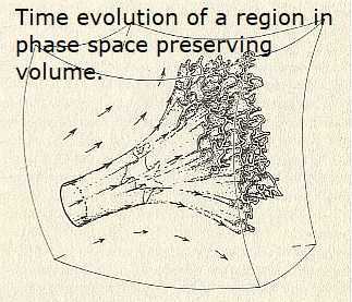

Phase Space and Liouville
In classical mechanics we learn of phase space;  meaning the multidimensional space formed by position x and momentum p degrees of freedom.  In A below, we see a depiction of phase space (showing on only one x and one p axis).  Each distinct point can be considered a possible microstate as in A.  In time, the states can evolve to other places in phase space, as in B.  But the never fork, and never converge (as in C), thus conserving the number of distinct microstates.  A, B, and C are the continuous analogs of the discrete evolutions (blue, yellow, and red boxes) we started with above.
Even better,time evolution Liouville’s Theorem[viii] says that if we choose a region in phase space (see D above); it evolves in time to different positions and shapes, but it conserves the volume in phase hyperspace.    Liouville’s Theorem is often said to express the conservation of information in classical mechanics.   Referring to the little picture on the right, drawing the boundaries of the volume determines the system, and thus the information.   The shape of the boundary (state) evolves with time.  Evolution can be ordered or chaotic.
Is entropy conserved too?  In general, no. (again system↔information state↔entropy)  However, if we fork the definition of entropy to include coarse versus fine grained entropy, that leads to an interesting side topic.

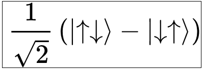

Entanglement Example
Here’s another example.  Singlet EquationConsider a system of two free electrons.  Electrons are spin ½ particles, and we can know their spins because there is an observable for a spin.  Now consider what happens if the two electrons become fully entangled in the singlet pair state which is spin 0.  There is no observable for the singlet to return the spins of the component electrons.  This is a time of evolution where information is conserved, but knowledge (or knowability) is not conserved.  The state changed, but the system remained the same.   Remember also that the electrons can also become disentangled thus restoring the original knowledge, while the information of the two-electron system remains invariant throughout.
This example illustrates why I prefer to define information and knowledge as distinct things.

    Even better, Liouville’s Theorem[viii] says that if we choose a region in phase space (see D above); it evolves in time to different positions and shapes, but it conserves the volume in phase hyperspace.My understanding of Liouvilles Theorem is that it deals with a conserved "density" defined on phase space, not with the concept of "volume" alone. Perhaps "phase space" in physics has definition that involves this density in addition to the ordinary mathematical concept of "volume"?
