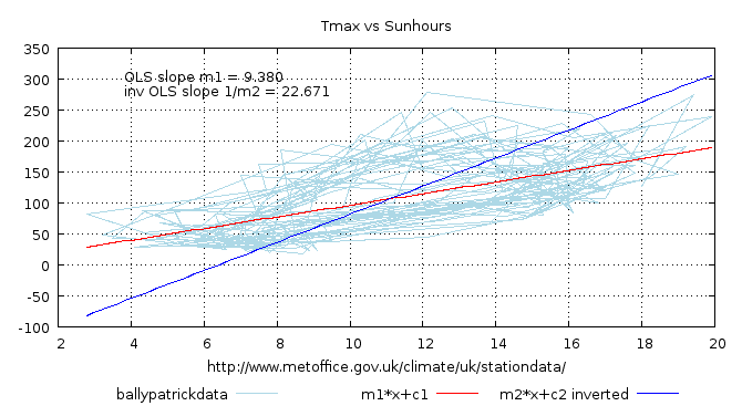

      Here is real some meteorological data with significant experimental error in both variables. A linear regression was done, first on x then on y. The two OLS slopes are both invalid because each one ignores the errors in one or other variable. OLS should never be applied to this kind of data in either direction.
      It would be possible to construct data where the true slope lies outside this range but usually the true slope will lie between these two extremes. ( The locus of the points was plotted for other reasons , that is not relevant to this discussion. )
      As can be seen this is not some purist pendant point , it can make an enormous difference to the supposed linear relationship between the two variables.
      I never cease to be amazed by the calibre of scientists and mathematicians who are totally unaware of proper use of this technique, which is one of the most fundamental tools of data analysis. One of the main reasons seems to be that it is not being taught properly in high school.
      Even if there is not time to go into the details of the maths it would seem important to at least mention that it only minimises y residuals and that the basic criterion for this work properly is to have very small errors on the x axis variable. It is only under those conditions that it will produce the "best unbiased linear estimation" of the slope.
