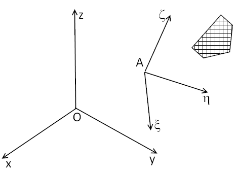

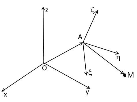

Assume  we have a fixed coordinate frame ##Oxyz##,  a moving frame ##A\xi\eta\zeta## and a point ##M## which moves in accordance to a law of motion $$\boldsymbol {OM}=\boldsymbol {OM}(t)=x(t)\boldsymbol e_x+y(t)\boldsymbol e_y+z(t)\boldsymbol e_z.$$
Velocity and acceleration of ##M## obviously are $$\boldsymbol v^M=\dot x(t)\boldsymbol e_x+\dot y(t)\boldsymbol e_y+\dot z(t)\boldsymbol e_z,\quad \boldsymbol a^M=\ddot x(t)\boldsymbol e_x+\ddot y(t)\boldsymbol e_y+\ddot z(t)\boldsymbol e_z.$$
If ##\boldsymbol {AM}(t)=\xi(t)\boldsymbol e_\xi+\eta(t)\boldsymbol e_\eta+\zeta(t)\boldsymbol e_\zeta## then by definition the velocity and acceleration of ##M## relative to the frame ##A\xi\eta\zeta## are given by the formulas
$$\boldsymbol v_r^M=\dot \xi(t)\boldsymbol e_\xi+\dot\eta(t)\boldsymbol e_\eta+\dot\zeta(t)\boldsymbol e_\zeta,\quad \boldsymbol a_r^M=\ddot \xi(t)\boldsymbol e_\xi+\ddot \eta(t)\boldsymbol e_\eta+\ddot \zeta(t)\boldsymbol e_\zeta.$$
Definition. Let us imagine that the point ##M## is attached rigidly to the moving frame ##A\xi\eta\zeta## i.e. its coordinates ##\xi,\eta,\zeta## do not change. Under this assumption the point ##M## is connected with the moving frame would possess a certain velocity and a certain acceleration relative to the fixed frame. These velocity and acceleration are called the velocity of transport and the acceleration of transport and denoted by ##\boldsymbol v_t^M,\boldsymbol a_t^M## respectively.
Let ##\boldsymbol \omega_t## stand for the angular velocity of the frame ##A\xi\eta\zeta## and ##\boldsymbol \epsilon_t=\dot{\boldsymbol\omega}_t## be the angular acceleration of the frame ##A\xi\eta\zeta##.
Definition. The vector ##\boldsymbol a_c^M=2\boldsymbol\omega_t\times \boldsymbol v_r^M## is called the Coriolis acceleration.
Theorem. The following formulas hold
$$\boldsymbol v^M=\boldsymbol v_r^M+\boldsymbol v_t^M,\quad \boldsymbol a^M=\boldsymbol a_r^M+\boldsymbol a_t^M+\boldsymbol a_c^M;$$ and
$$\boldsymbol v_t^M=\boldsymbol v^A+\boldsymbol\omega_t\times\boldsymbol{AM},\quad \boldsymbol a_t^M=\boldsymbol a^A+\boldsymbol \epsilon_t\times \boldsymbol{AM}+\boldsymbol\omega_t\times(\boldsymbol\omega_t\times\boldsymbol{AM}).$$
Now assume that we have a moving rigid body and its angular velocity and angular acceleration are ##\boldsymbol \omega,\boldsymbol\epsilon.## Let  ##\boldsymbol \omega_r,\boldsymbol\epsilon_r## stand for angular velocity and angular acceleration of the rigid body relative to the frame ##A\xi\eta\zeta##.
Theroem. The following formulas hold
$$\boldsymbol \omega=\boldsymbol \omega_t+\boldsymbol \omega_r,\quad \boldsymbol \epsilon=\boldsymbol \epsilon_t+\boldsymbol \epsilon_r+\boldsymbol \omega_t\times\boldsymbol \omega_r.$$
