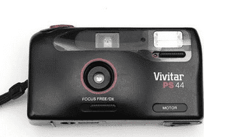

    Blank_Stare
    Please explain how the PVC pipe, or sewing thread spool helps you grind down the lenses? It sounds like you may know a useful trick that I'd like to learn more about.No, no you use the lens as is.
    the lens out of those "point & shoot" cameras (thrift shops are full of them)
    is about 3/8 inch diameter . Cheap ones are plastic better ones glass.
    I put it in something that i can sand to fit into the telescope eyepiece holder.
    Sorry for the confusion.
    old jim
    Log in to Reply

  10. jim hardy
    jim hardy says:
    June 25, 2017 at 3:38 pm
    Blank_Stare
    Is that a standard for sizing eye-pieces?I think one inch is standard , 25.4 mm. OOPS TIL it's 0.965 inch, as Dennis pointed out below.
    I've never seen "blacked out" eyepieces.
    Blank_Stare
    if anyone has a favorite source for buying eye pieces that will fit this telescope,Are you handy with small hand tools?
    Old film cameras are literally a buck or two in thrift shops. I take them apart for the lens which i can put in a PVC pipe fitting or old sewing thread spool and sand down to 1 inch..
    Standard focal length is about 35 to 50 mm, wide angle is shorter. I have a zoom lens out of a fancy little Canon that should be fun but have yet to mount it
    "Focal" was an inexpensive department store brand. It'll do the job of getting you started.
    Its objective lens(the big one) is 60mm diameter, its focal length is 700 mm, .
    magnification is (focal length of objective) / (focal length of eyepiece)
    so your 6 mm eyepiece gives 700/6 = 117 X which is completely unusable on a cheap tripod because you can't keep it still let alone aim it.. But power sells.
    Your 20mm gives 700/20 = 35 X way more useable and great for moon and Jupiter, it'll show Saturn's rings.
    A 35 from a thrown away camera will give 20X great for the moon.
    Eclipse ?
    I'd say use your telescope to project an image of the sun onto another surface, as in this article
    http://www.skyandtelescope.com/astronomy-news/how-to-look-at-the-sun/
    Log in to Reply

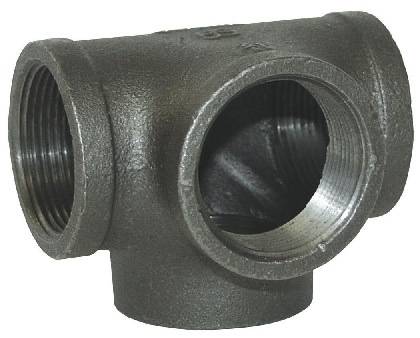

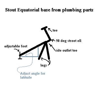

  16. jim hardy
    jim hardy says:
    May 18, 2017 at 8:34 am
    Dad built an equatorial mount from plumbing fittings. A 2 inch Side Outlet Tee makes for sturdy leg mounts.
    will post a photo if i can find one.
    Log in to Reply

    Advice given above regarding a hookup with local enthusiasts is most excellent. Do-It-Yourselfer's are always eager to help out.
    The guys at Southern Cross club showed us how to improve our mirror mounting scheme
    and how to make an equatorial mount from plumbing fittings.
