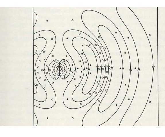

The magnetic field at distance r from a short (## d \ll \lambda ##) dipole antenna is obtained by computing the magnetic retarded potential ## \bf A ##. From ## \bf A ## one finds the magnetic-field components and then the E-field components. The last step is done either by using the remaining Maxwell equation or by imposing the Lorentz gauge ## \nabla \cdot \bf A = -\mu \epsilon~\partial V/\partial t ## (cf. Ref. 5). That reduces the E-field expression to an equation in terms of ## \bf A ## alone. I will not repeat these standard derivations here; they are in the usual textbooks.
Electric and Magnetic Fields Near a Radiating Short Dipole
Figure 1 — Electric and Magnetic Fields Near a Radiating Short Dipole Antenna
From Es to Em
Figure 1 (Ref. 5) shows how the Em field is generated from the Es field. The electric wave begins as a predominantly Es field close to the antenna, indicated by flux lines between charges attached to the antenna. From the beginning, that Es field produces an H field (indicated by dots for into/out of the page). This H field, via Maxwell’s equation ## \nabla \times \bf H = \partial \bf D/\partial t ##, generates the closed-loop Em field. As the field radiates away from the antenna, the Es contribution diminishes while the Em contribution becomes dominant. For r > 1 wavelength the wave is essentially wholly Em and no longer coupled to antenna charges.

In the far (radiation) field, the surviving E component is ## E_{\theta} ##, which falls off as ## 1/(\lambda r) ##. At large distances the E field is essentially entirely Em. (The idea of electrons “flying through the air” is picturesque but strictly metaphoric: no charges, no Es field.)
There is an intermediate zone where ## E_r ## and ## E_{\theta} ## coexist and the dominant decay is roughly ## 1/r^2 ##. At the distance where ## \lambda/r = 2\pi ## the Es and Em amplitudes are comparable.
Visualization of the evolving radiation pattern
Figure 1 gives a clear visual of fields at near, intermediate, and long distances from the antenna. Very near the antenna the field is nearly all Es, but an H field appears immediately via ## \nabla \times \bf H = \epsilon_0 \partial \bf E_s/\partial t ##. Further out, that H field produces an Em contribution (via ## \nabla \times \bf H = \epsilon_0 \partial \bf E_m/\partial t ##). Thus Es transitions into a mixed Es+Em field and ultimately into a nearly pure Em field that propagates away in closed loops, effectively independent of the antenna charges at large r.
