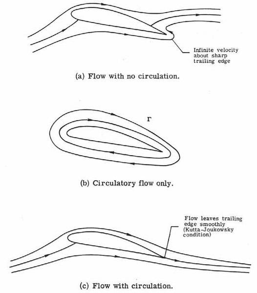

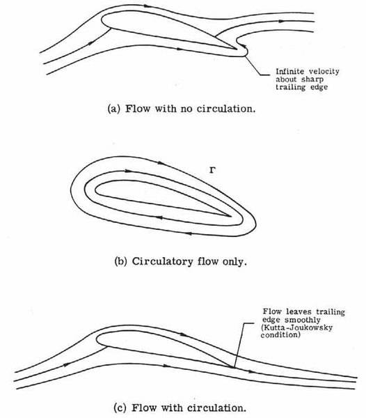

      In figure (a), assume that the wing has negligible density compared with the fluid. It is constrained from rotating or moving left / right. But it is totally free to move up or down (no restoring force in Y direction).
      In that case, would it drift downwards over time? And if we now add a constraint against this drift, how much force would we measure?

      I just realized that the animation in your Lift article (i.e. the one I pasted in my previous post) is actually showing inviscid flow, not viscid flow. So that answers my question. I had wrongly assumed that this is viscid flow.It's inviscid, but it's including an important element of viscous flow. Specifically, inviscid theory alone would predict streamlines more like the top image shown here (which would generate zero lift):
      Viscosity is what enforces that the flow comes smoothly off the sharp trailing edge of the airfoil, modifying the flow from the top image to the bottom image. Frequently, when analyzing lift and flow about an airfoil, it is modeled as inviscid, but with this condition of smooth flow off the trailing edge enforced to give you a physically reasonable flow.
      I guess it makes kind of sense, because the incoming and outgoing angles are nearly equal for each and every streamline, hence no net momentum change so no lift.
      Edit: Wait, that's obviously not correct. It means there is a net upward lift. Sorry.
      It may be instructive to see the streamlines side by side for exactly the same airfoil, with and without viscosity.

      If that flow was inviscid, the flow on bottom would wrap around the sharp trailing edge and leave the shape somewhere back around on the top surface.
