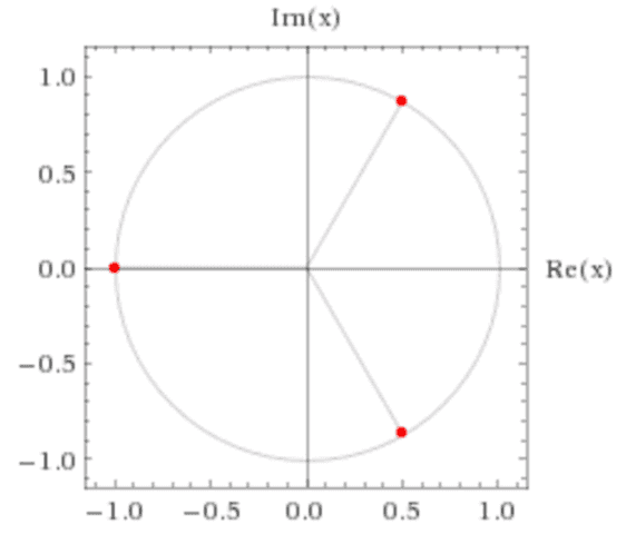

What are the roots of the cubic equation ##x^3=-1##?  The answer is simple and obvious to us, but it is one of the problems that bedeviled ancient mathematicians.  The roots are at ##\sqrt[3]{-1}##, but what does that mean?  It means there are three roots, ##-1##, ##1\angle 60##, and ##1\angle -60##.  Once again, Complex math makes it simple.  It becomes simpler still when we think of circles and rotation operators and show the results graphically. To take a cube root, simply divide the circle into three equal parts.
The two complex roots above are complex conjugates.  Conjugates have the same magnitude of rotation, but the opposite direction of rotation.  In rectangular coordinates, the conjugate of ##a+ib##  is ##a-ib##. In physics and engineering, complex quantities very often appear as complex conjugate pairs.  Now you know what that means.
