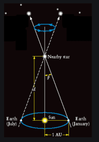

In order to obtain distances in astronomy, astronomers use the “cosmic distance ladder.” That is, they obtain farther distances using information obtained at smaller distances. For example, using the Earth-Sun distance astronomers measure the parallax angle to relatively nearby stars to obtain the distance to those stars (see picture below and this Insight by Janus). The distance to a star with a parallax angle of one arcsecond is defined to be 1 parsec (pc). Using the known Earth-Sun distance you can compute 1pc = 3.26cy (again, read “cy” as “light-years”). They can use this method on thousands of stars in our galactic neighborhood. Once they know how far away a star is, they can figure out how intrinsically bright it is, i.e., how bright it would appear at a particular reference distance (chosen here to be 10pc). Doing that for many stars allows them to build a table of information on types of stars (called the H-R diagram).
Now, when they see a star of a particular type that is too far away to exhibit a measurable parallax angle, they can deduce its distance by using its intrinsic brightness from the H-R diagram (given a number ##M## called its “absolute visual magnitude,” as I will explain below) and comparing that to its apparent brightness (given a number ##m## called its “apparent visual magnitude,” as I will explain below). This method is good as long as you know an object’s intrinsic brightness and the object is bright enough to be seen at all. It turns out that for your average star this method isn’t good for cosmological distances because stars just aren’t bright enough to be seen at cosmological distances. What Perlmutter, Schmitt, and Riess did to win the 2011 Nobel Prize in Physics was to figure out ##M## for a very bright object that can be seen billions of light-years away — the type Ia supernova. Specifically, they were able to obtain the “distance modulus” ##m\, – M## and redshift for hundreds of distant supernovae. That is the SCP Union2.1 data I will fit using EdS and ##\Lambda##CDM kinematics obtained in Parts 1 and 2 of this series. To get started, I need to explain distance modulus quantitatively.

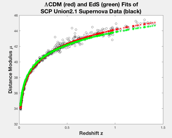

%This is where I do my plots (shown below).
plot(z,mu,’o’,’color’,’black’)
hold
plot(z,TheoryMuLCDM,’*’,’color’,’red’)
plot(z,TheoryMuEdS,’*’,’color’,’green’)
title({‘\LambdaCDM (red) and EdS (green) Fits of’;’SCP Union2.1 Supernova Data (black)’},’FontSize’,17,’FontWeight’,’bold’)
xlabel(‘Redshift z’,’FontSize’,15,’FontWeight’,’bold’)
ylabel(‘Distance Modulus \mu’,’FontSize’,15,’FontWeight’,’bold’)
hold off
Using RMSE is a crude way to determine the best fit, but it results qualitatively in precisely what is publicized about the role of ##\Lambda##. That is, ##\Lambda## plus EdS produces a greater ##\mu## at large redshifts than EdS alone (see my plots below). This discovery by Perlmutter, Schmitt, and Riess caused quite a stir in astronomy when it was announced in 1998, but today the use of ##\Lambda## in the concordance model for cosmology is unquestioned. The quantum source of this so-called “dark energy” remains a mystery however.
