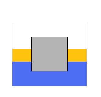

Example: “A cube of mass m and height a floats upright in a tank containing water density ##\rho_w## and oil density ##\rho_o##.  If the height of the top of the cube above the oil is h, how high is it above the oil/water boundary?”
The challenge is to figure out the displaced volume of each fluid.
buoy1a
Imagine removing the solid body, leaving a cavity which the fluids would flow back into.
buoy2a
The displaced bodies of fluid are what would be needed to fill the cavity in such a way that the fluid already present would stay put.
If you were to insert the additional fluid such that some part of the cavity below the oil/water boundary contained oil, that would not be stable.
buoy3a
Similarly, any fluid above that boundary, or any oil below the oil/water boundary, and so on.  There is only one stable arrangement:
buoy4a
If the top of the cube is height y above the oil/water boundary then the volume of water displaced is ##a^2(a-y)## and the volume of oil displaced is ##a^2(y-h)##.
