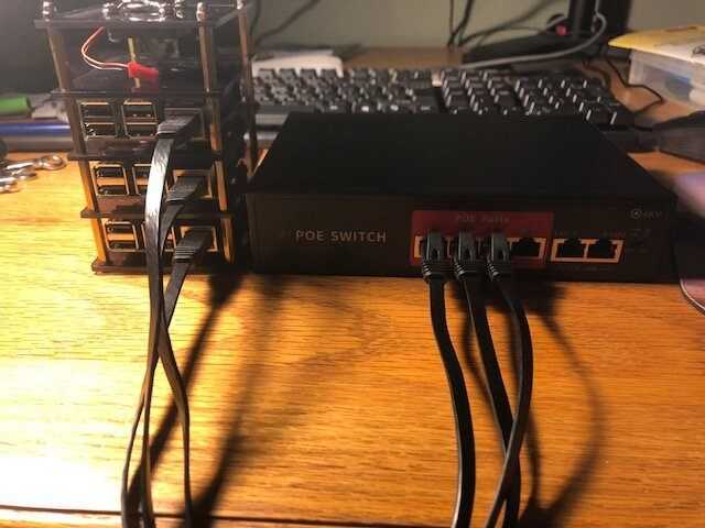

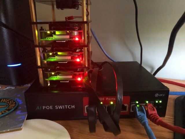

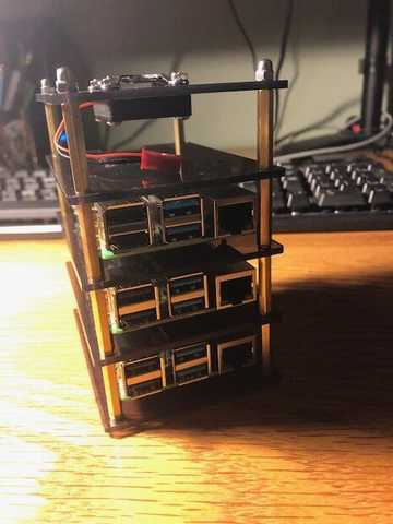

So, I’ve told you about all the aggravation I went through to get the cluster to this point. That is all well and good, but what does it really look like? Well, being the poor planner that I am (sometimes) I didn’t think about pictures while I was putting all the parts together, but here are some images of the completed project.
pi case
Figure 1: The pi case
pi powered hub
Figure 2: Pi’s and power over ethernet hub
pi cluster
Figure 3: Pi Cluster powered up and networked in
