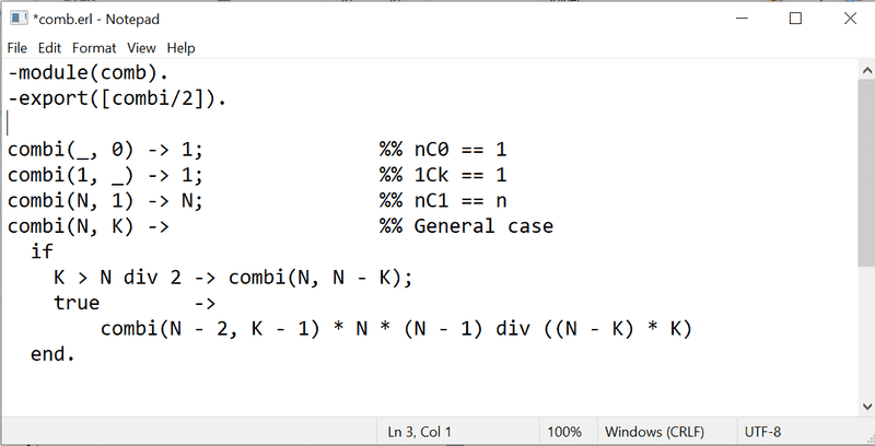

    12. Mark44
      Mark44 says:
      December 9, 2022 at 6:31 pm
      Interesting, I would have thought the compiler could have sorted it out (perhaps there is a higher level of optimization you can select) but I think you need
      [code=erlang]
      true ->
      (N * (N – 1)) div ((N – K) * K) * combi(N – 2, K – 1)
      [/code]
      I’m not familiar enough with the compiler and its settings to know if I can adjust this.
      Regarding your suggestion, I actually tried that, but got incorrect results, due to integer division being performed at the wrong time. For example, for ##~_5C_2## the factor to the left of the call to combi() is
      $$\frac{5 \cdot 4}{3 \cdot 2}= \frac {20} 6$$
      With integer division, this works out to 3. The other factor, from the call to combi(), is ##~_3C_1## or 3, so the result would be 3 * 3 = 9.
      If the factors are placed in the proper order, you get ##20 \cdot 3 \text{ div } 6##, or 10, the correct value. I haven’t run across any information about operator precedence an associativity, but it’s almost certainly the case that multiplication and division are left-associative.

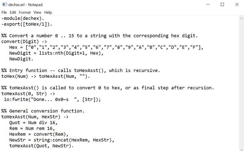

      I’ve taught a lot of introductory programming classes over the years, mostly in C or C++, but also in other languages, such as Modula-2 (one time) and MIPS assembly (a half-dozen times). In all of these classes I’ve had students write programs that feature functions and in most I have assigned problems in which they write recursive functions.
      A few years back I got interested in Lisp and wrote several programs in that language. More recently I have developed an interest in functional programming, and have been learning Erlang, a language that was developed by Ericsson AB, a Swedish telecom company.
      In my classes, whenever I presented material on recursive functions, I tried to come up with examples other than the ubiquitous factorial function or the Fibonacci function, examples of which seem to appear in every programming textbook that covers recursion.
      Two examples that I think are interesting feature recursive functions that 1) convert a decimal integer into its hexadecimal form, and 2) calculate the binomial coefficient ##\binom {n}{k}##, also written as ##~_nC_k##. The binomial coefficient gives the number of combinations of n items taken k at a time.
      Here’s the first of these, in Erlang. It converts a decimal integer to its hexadecimal form.
      [ATTACH type=”full” alt=”dechex.png”]318524[/ATTACH]
      For some reason, the forum software wouldn’t let me insert the code as text inside code tags, so I’ve attached the code as images. I’ve done a fair amount of testing, and this code seems to work well. Most of the work of recursion is done in the second toHexAsst() function, in which the last line calls the function recursively, making it tail-call recursive. In Erlang, a recursive function with tail-call recursion gets converted by the compiler into a loop, so there’s not the problem of blowing up the stack if recursion goes too deep.
      The other example calculates the binomial coefficient, ##~_nC_k##. This is something I’ve never come across in my reading. I’ve omitted the comments I have in the code, but I’ll provide a brief explanation here.
      If f(n, k) = ##~_nC_k##, a recurrence relation is f(n, k) = n*(n – 1) * f(n – 2, k – 1) / [ (n – k) * k].
      So, ##~_nC_k## = n * (n – 1) / [(n – k)*k] * ##~_{n – 2}C_{k – 1}##. The division here is integer division, which is guaranteed to be exact by virtue of the numbers involved.
      By symmetry ##~_nC_k## = ##~_nC_{n -k}##. For example, ##~_8C_5 =~_8C_{8 – 5} = ~_8C_3##. This is easy to confirm by writing a few rows of the Pascal Triangle, which contains the binomial coefficients.
      [ATTACH type=”full” alt=”combi.png”]318523[/ATTACH]
      This one isn’t tail-call recursive, and I can’t for the life of me figure out how to make it so. Previous attempts produced incorrect values due to the integer division being performed too early.
