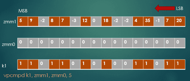

Setting an Opmask Register
One way to set the bits in an opmask register is to use one of the comparison instructions:
vpcmpd k1, zmm1, zmm0, 5
This instruction works on a vector, performing a packed compare of dword (32-bit integer) data. The fourth operand, 5, indicates that the comparison is “not less than.” This is one of eight possible predicates, including less than (1), equal to (0), not equal to (4), and others. These values are described in the Intel® 64 and IA-32 Architectures Software Developer’s Manual.
opmask register
Fig. 1 Compare (not less than) the values in ZMM1 with those in ZMM0. Each value in ZMM1 that is not less than 0 causes a bit to be set in the k1 opmask register.
In the figure above, the vpcmpd instruction subtracts each value in ZMM0 from its paired value in ZMM1. If the result is not less than 0, the corresponding bit in k1 is set to 1. Note that although k1 has 64 bits, only the lowest 16 bits are used here.

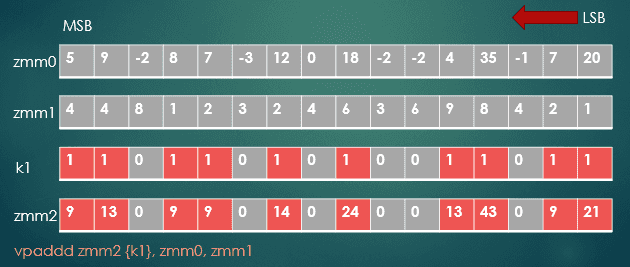

Addition Controlled by an Opmask Register
The final step is to use the opmask registers. To do this we’ll use an addition instruction that was newly added to the AVX-512 instruction set: vpaddd. As before, v indicates a vector instruction: the packed add of dword (32-bit integer) data.
 vpaddd zmm2 {k1}, zmm0, zmm1
The following figure describes the operation of this vpaddd instruction. The values in ZMM0 and ZMM1 are added, but only the values in ZMM0 with a paired value of 1 in the k1 register are written to ZMM2.
conditional addition opmask register
Fig. 2 Conditional addition of values from one register to another, based on the set bits in an opmask
