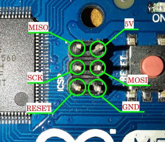

ICSP header pinout
The headers have the following pinout:
ICSP headers pinout
The pinout of the ICSP headers is also shown in the ArduinoISP sketch in the comments.

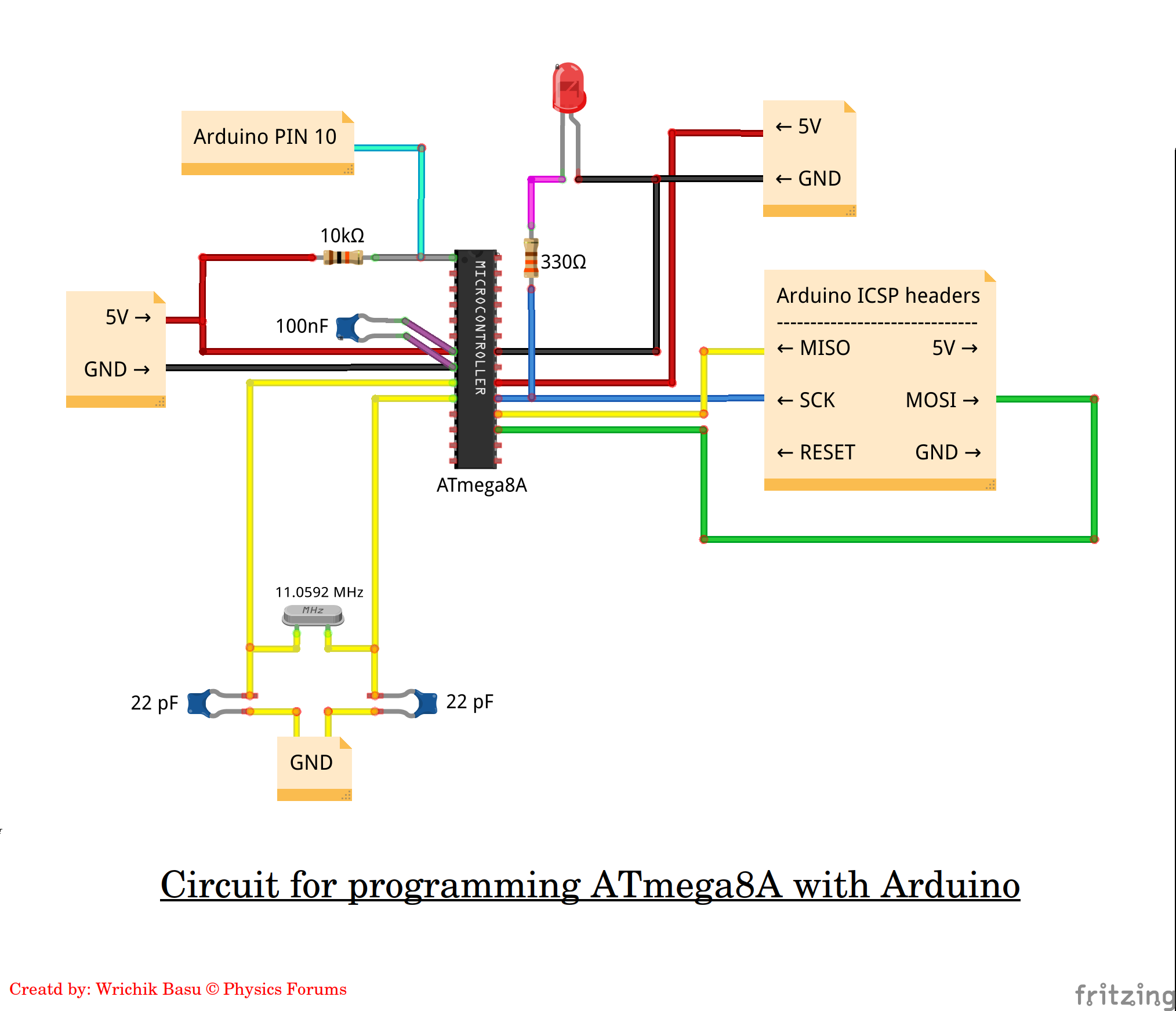

Full circuit diagram
The full circuit, connecting the Arduino to the ATmega8A, is shown in the following diagram:
Circuit for programming ATmega8A with Arduino
Notes on connections
A few points to note:
  • We do not use the ##mathtt{RESET}## pin of the ICSP header. We have connected the ##overline{mathtt{RESET}}## (pin PC6) of the ATmega8A to pin 10 of the Arduino board and not to the ICSP header. The ##mathtt{RESET}## pin of the ICSP header corresponds to the ##overline{mathtt{RESET}}## of the on-board MCU. Resetting the ATmega8A and the onboard MCU are two different stories and are not related to each other. We should be able to reset the ATmega8A independently when we are programming it. To this effect, the ArduinoISP sketch, by default, uses the digital pin 10 on the Arduino board. Hence, irrespective of the board you are using, the ##overline{mathtt{RESET}}## of the ATmega8A will always be connected to digital pin 10 on the Arduino board. You may change this pin as per your wish by modifying the ArduinoISP sketch.
  • I have used an ##11.0592~mathrm{MHz}## crystal. You can choose any crystal from this list.
  • While burning the bootloader or uploading a sketch, you have to compulsorily power the ATmega8A from the Arduino board. You may use the 5V and GND pins on the ICSP header, or directly connect to the 5V and GND sockets on the Arduino board. If you are prototyping on a breadboard, then you may connect the power rails to the Arduino board.
