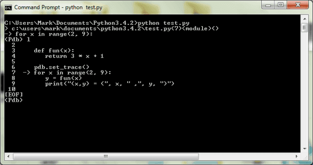

Here is the result of typing l (ell) at the Pdb prompt:
Fig2

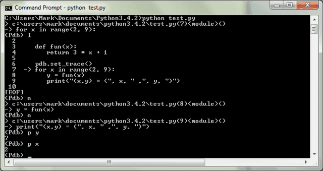

Pressing n or typing next takes us to the next line of code. Pressing n again takes us to the print() statement at the end of the loop body.
Another command, s or step, is similar to n (or next) but will step into a function call rather than stepping over it as s does.
In the next screenshot, the current line is the print statement at the end of the loop body.
Fig3
An important feature of any debugger is the ability to display the value of a variable. This we can do with the p (or print) command. In the screenshot above, the current line is the print statement, which means it is the next statement to execute. The previous statement, “y = fun(x)” has been executed, so we can see the value of y and x as shown below.
Fig4
In the screenshot above, we can see that p y results in a value of 7, and p x results in a value of  2.

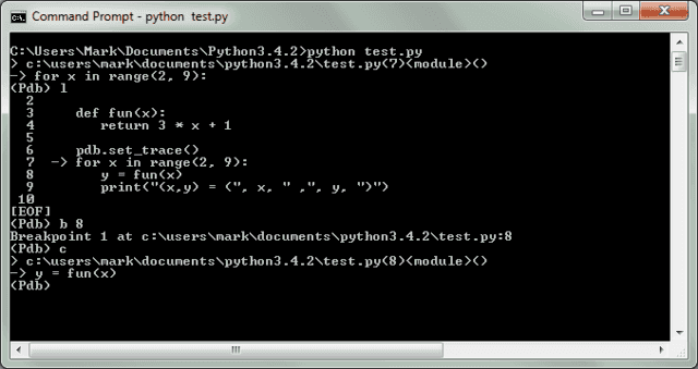

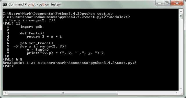

Let’s look at another important capability of debuggers: breakpoints. When you set a breakpoint in a program, the debugger executes all of the code up to the breakpoint and then halts. This allows you to inspect variables at that point in the program.
To set a breakpoint, use the Pdb command b or break, followed by the line where you want the breakpoint. It’s helpful to press l (lowercase L) or ll to list (or longlist) your program code with line numbers, as I have done in the following screenshot. The l and ll commands were discussed in the previous Insight article. In this screenshot, the command b 8 means that I’m setting a breakpoint at line 8.
Fig4
Instead of single-stepping through the code using n or s (next or step) as I did in the previous article, we can use the c (or cont or continue) command to execute code until we reach a breakpoint. The next screenshot shows the result of pressing c — execution stops at the line with y = fun(x)  on line 8, which is where I set the breakpoint.
Fig8
Pressing c again causes the print() statement to execute, and then starts another iteration of the for loop. Execution stops for the second time at line 8.

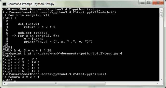

You can also set a breakpoint to be triggered conditionally, by adding a logical condition after the line number. I’m going to clear (cl or clear) the breakpoint I set at line 8, using the command cl 1. This was the first breakpoint I set, so its number is 1. Then I’m going to set a new breakpoint inside the function fun(), but only after the expression to be returned is larger than 20.
To do this I use the command b 4, 3 * x + 1 > 20. This command means, “set a breakpoint at line 4, and trigger it when 3 * x + 1 is larger than 20.” Note that you must use a comma between the line number (4) and the logical expression 3 * x + 1 > 20.
 Fig11
After setting the breakpoint and the logical condition, I’ll press c to continue execution until the breakpoint is hit. As you can see in the following screenshot, my program has processed x values of 2, 3, 4, 5, and 6, and has stopped inside the fun() function when x is 7, and 3 * x + 1 is 21, the first value that was larger than 20.
 Fig12
