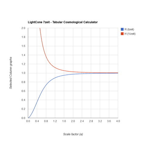

Here is a graph of the two equations, H (red) and R = c T_H (blue) against the expansion factor a, with both curves approaching the value 1.0. T_H has the same numerical value as the Hubble radius R in the graph.
normalized Hubble value
Fig 1.2 The normalized Hubble value (H) and its inverse, the Hubble radius (R), which is numerically the same as the Hubble time in the units used here (c=1).
The present Hubble time is 0.832 zeit (14.4 Gy) and it is expected to approach one zeit (17.3 Gy) in the far future.
