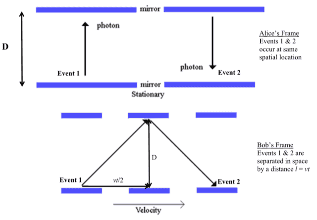

First suppose that a light pulse bounces back and forth between mirrors separated by a distance D (top half of Figure 1). Alice, at rest with respect to the mirrors, measures a time T for the light pulse to leave from the bottom mirror (Event 1), bounce off the top mirror, and return to the bottom mirror (Event 2). Thus, Alice says
\begin{equation} c = \frac{2D}{T}  \label{Alice1} \end{equation}
Now suppose Alice is moving to the right with respect to Bob at speed v. Bob measures a time t between Events 1 & 2 with the light pulse taking the path shown in the bottom half of Figure 1. Since everyone measures the same speed of light, Bob computes
\begin{equation} c = \frac{2\sqrt{D^2 + \frac{v^2t^2}{4}}}{t}  \label{Bob1} \end{equation}
Solving for t(T) we find
\begin{equation} t = \frac{T}{\sqrt{1 – \frac{v^2}{c^2}}}  \label{time1} \end{equation}
T is called the “proper time” between Events 1 & 2 because those two events occur at the same location in space for Alice. For Bob, those two events occur at two different locations in space and his time t is longer than the proper time T. That observers measure the time between events occurring at two different locations in space to be longer than the proper time between those events is called “time dilation.” Thus, Bob says Alice’s clock runs slow. Of course since motion is relative, it must also be the case that Alice says Bob’s clocks run slow compared to hers. I’ll explain how SR allows these seemingly contradictory facts to hold in part 2 of this series. I will say now that the resolution of this paradox has nothing to do with the time delay of light in getting from one point to another, i.e., it’s not an optical illusion, all measurements will be made locally. Finally, let me introduce length contraction.
Suppose Alice is crashing through two walls at rest with respect to Bob at Events 1 & 2. These walls are separated by a distance l = vt according to Bob. Motion is relative, so Alice says Bob is moving to the left at speed v, i.e., they must agree that their relative speed is v. Since Alice says the time T between Events 1 & 2 is shorter than the time t that Bob says passes between Events 1 & 2 by a factor of [itex]\sqrt{1 – \frac{v^2}{c^2}}[/itex], Alice must therefore also say her distance L between the walls of Events 1 & 2 is shorter than Bob’s distance l by the same factor, i.e.,
\begin{equation} l = \frac{L}{\sqrt{1 – \frac{v^2}{c^2}}}  \label{length1} \end{equation}
Bob measures what is called the “proper length” between the walls, since he is at rest with respect to the walls, so Alice measures a shorter length than the proper length. That observers in motion with respect to an object measure its length to be shorter than its proper length is called “length contraction.” Thus, Alice says Bob’s meter sticks are shorter than one meter. Of course since motion is relative, it must also be the case that Bob says Alice’s meter sticks are shorter than one meter. I’ll explain how SR allows these seemingly contradictory facts to hold in the next (second) Insight of this series.
Figure 1
