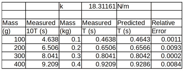

Set up columns in your analysis spreadsheet like in Table 1. You will need the spring constant, k, for some calculations, so enter it in a cell near the top. The two leftmost columns [mass (g) and 10 T (s)] should contain your raw data, exactly as you wrote it in your lab notebook. The third column should be the mass converted to kg (divide by 1000 to convert g to kg). The fourth column should be the measured period, T, computed by dividing the measured 10 T by 10. The fifth column should be the predicted period, T, for each mass, computed with a spreadsheet formula like =2*3.1415926*SQRT(C5/$D$1), assuming the spring constant, k, is in element D1 and the mass in kg is in element C5. Note the $D$1 will allow the formula to be pasted into lower cells in the same column and keep the reference to the cell with k. The sixth column contains the relative error between the predicted and measured periods computed as the (Predicted T – Measured T)/Measured T, or =(E5 – D5)/D5.
Data and analysis for the simple harmonic oscillator
Table 1: Data and analysis for the simple harmonic oscillator comparing measured and predicted periods for each mass.

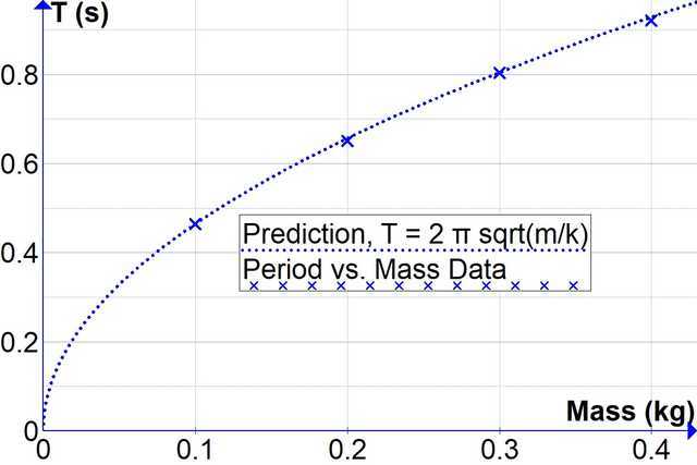

Period T vs. Mass Predictions and measured data for simple harmonic oscillator
Figure 1: Period T vs. Mass Predictions and measured data for the simple harmonic oscillator.

Your results should include a table containing your measured 10T, the predicted period, the measured period, and the relative error in the prediction. Make sure to record things according to the experiment you performed rather than the example in the instructions or how you think things should have gone. If there is a major discrepancy between your predicted and measured values, you may retrace your steps and try and find where you made the error. The most likely sources of error over 2% are errors in measuring the period, entering wrong values, or an error measuring the spring constant.
