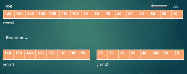

A good way to explain this process is by seeing how the affected registers change, step by step. As an example, suppose that ZMM0 contains the four-byte integer (DWORD) values as shown in Fig. 1. Just as a check, these numbers add up to 1360, so if the computer gives another result, there’s a problem in our code.
Fig. 1 - ZMM0 is initialized with 16 DWORD (int) values
Fig. 1 – ZMM0 is initialized with 16 DWORD (int) values
Splitting a Register into Two Halves
The horizontal addition instructions work only on XMM (16 byte) or YMM (32 byte) registers, so we need to split ZMM0 into two YMM registers, as shown in Fig. 2. We can split it into a lower half, which is YMM0. (The lower 256 bits of registers ZMM0 through ZMM15 is a YMM register with the same numeric suffix.) The upper half of ZMM0 can be extracted and inserted into YMM1. This is done using the instruction vextracti32x8 ymm1, zmm0, 1. The number 1 in this instruction indicates that we want the upper 256 bits; a value of 0 would mean to extract the lower 256 bits. The “i32x8” suffix on the instruction was chosen to reflect that fact that we’re extracting 8 32-bit integer values.
Fig. 2 - ZMM0 split into YMM0 and YMM1
Fig. 2 – ZMM0 split into YMM0 and YMM1
The next step is to add YMM0 and YMM1, storing the sum back into YMM0. We can do this using vpaddd ymm0, ymm0, ymm1. As mentioned in the previous article, we’re adding vectors of packed dword quantities.

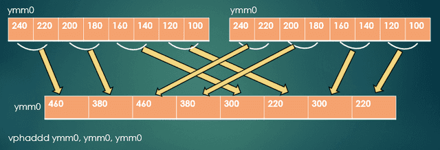

First Horizontal Addition
Next, we’ll use horizontal addition, as shown in Fig. 3. Here the instruction is vphaddd ymm0, ymm0, ymm0. The name of this instruction indicates that it does horizontal addition on vectors of packed dwords. Notice how pairs of numbers in either source register are added and stored in the destination register. Also notice that the eight values in the destination (at bottom in the figure)register are really duplicates of only four values.
Fig. 3 - How horizontal addition works
Fig. 3 – How horizontal addition works

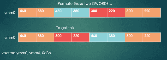

Swap the Middle QWORDs
If we reorder the four DWORDs in the middle (the middle quadwords, or QWORDs), all four distinct values will be in the lower half of YMM0. Fig. 4 shows this step. Doing this leaves the four partial sums duplicated in the lower and upper halves of YMM0. Keep in mind that the lower half of YMM0 is also called XMM0. The instruction vpermq ymm0, ymm0, 0d8h does the swap for us, but requires a bit of explanation. The literal 0d8h is the hexadecimal representation of the base-2 value 1101 1000. If we write this as 11 01 10 00 (binary), or 3 1 2 0, this tells the vpermq instruction to leave the QWORD values at index 0 and 3 alone, but to swap the positions of the QWORD values at indexes 1 and 2. If you didn’t notice, the ‘q’ suffix in vpermq means that it operates on QWORD quantities.
Fig. 4 - Permute the QWORDs at indexes 1 and 2
Fig. 4 – Permute the QWORDs at indexes 1 and 2

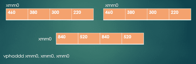

Second Horizontal Addition
After the permutation operation, we have the four partial sums in the lower half of YMM0; that is, in XMM0. The upper half of YMM0 contains that same set of four values, so we can ignore them. Next, as shown in Fig. 5, we’ll do another horizontal addition, this time using vphaddd xmm0, xmm0, xmm0. At this point, we’re almost done, with two partial sums in both the lower and upper halves of XMM0. One more addition should get us the sum we want.
Fig. 5 - Horizontal addition of XMM registers
Fig. 5 – Horizontal addition of XMM registers

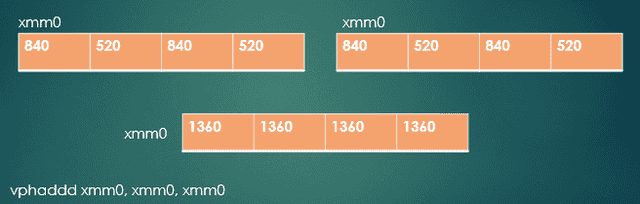

Third Horizontal Addition
Fig. 6 shows the result of one last horizontal addition, again using vphaddd xmm0, xmm0, xmm0. This leaves us with our answer — 1360 — in all four slots of XMM0.
Fig. 6 - The final horizontal addition
Fig. 6 – The final horizontal addition
All that’s left is to extract the lowest DWORD (four bytes) from XMM0, which we can do using vpextrd eax, xmm0, 0. This instruction extracts the DWORD at index 0 in XMM0, and stores it in the EAX general purpose register.
