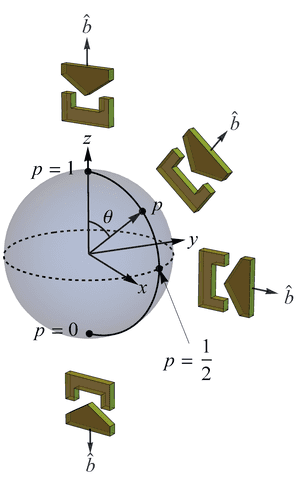

Figure 1. Probability state space for the qubit ##|u\rangle## in the ##z## basis plotted in real space reference frame of mutually complementary spin measurements, ##J_x, J_y, J_z##.

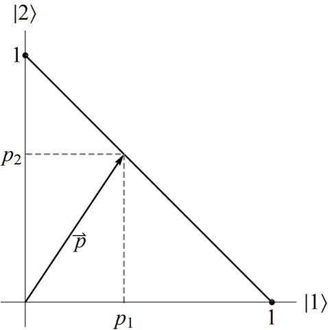

Figure 2. Probability state space for the classical bit.

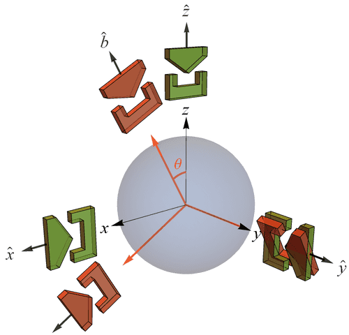

Figure 3. In this set up, the first SG magnets (oriented at ##\hat{z}##) are being used to produce an initial state ##|\psi\rangle = |u\rangle## for measurement by the second SG magnets (oriented at ##\hat{b}##).
