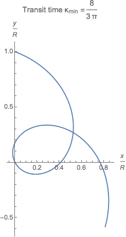

Shortest Transit Time
To illustrate with a concrete example how all this might work, let us assume a craft-tunnel combination such that ##\gamma = 5/4##. This value is sufficiently low to require a trajectory in the inertial frame that loops back on itself which makes it more interesting. We use equation (5) to find ##\kappa_{\min} = \frac{8}{3\pi} = 0.85##. This is more than half a period and less than a full period which implies that, regardless of the value of ##\phi_0##, the craft cannot just zip through the tunnel before the exit point crosses over into the “forbidden” ##x > 0## region. Thus, the value of ##\phi_0## must be such that the exit point B has traversed the entire forbidden region and is back in the allowed ##x < 0## region at time ##\tau = \kappa## when the craft exits.
The acceptable range of values for ##\phi_0## that will permit a valid trajectory is bracketed by two limits: the craft must (a) enter just to the right of the positive ##y##-axis or (b) exit just to the left of the positive ##y##-axis. Finding the first limit is easy; if ##\phi_0 = \pi/2##, the exit point, initially at ##3\pi/2##, will clearly be in the region ##x < 0## when its angular displacement is between half and a full revolution. For the second limit, we note that the angular position of the exit is given by ##\phi_B(\tau) = 2\pi\tau + \pi + \phi_0##. We require that at exit time ##\tau = \kappa## this be ##2\pi + \pi/2##.
$$2\pi\kappa + \pi + \phi_0 = 2\pi + \tfrac{\pi}{2} \;\rightarrow\; \phi_0 = \frac{3\pi}{2} – \pi\kappa$$
With ##\kappa = \frac{8}{3\pi}##, the range of entry angles is ##-36^\circ < \phi_0 < 90^\circ##. The parametric plot below shows the shortest time trajectory for ##\gamma = 5/4## and ##\phi_0 = -36^\circ##. The craft moves along the curve from lower right to the upper left. For other choices of ##\phi_0## values in the allowed range, as ##\phi_0## increases the trajectory will rotate about the origin until the entry point on the lower right reaches the positive ##y##-axis.
Shortest time trajectory

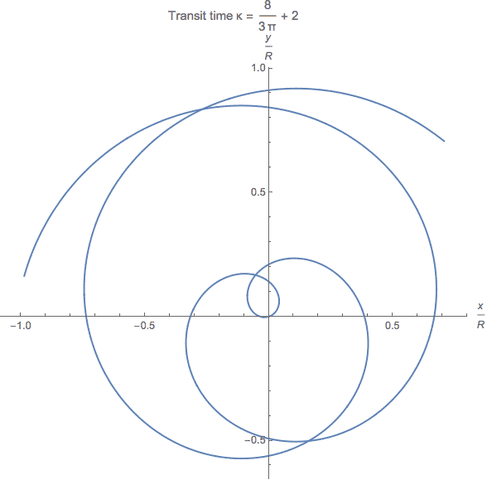

There is a multitude of solutions if we relax the shortest transit time requirement. For example, we may fix the entry angle ##\phi_0## and increase the transit time until the exit point touches the negative ##y##-axis. Furthermore, to all of the solutions obtained this way, we may add any number of integers to the value of ##\kappa##. The “scenic” trajectory shown below is an extension of the one shown above with new parameters ##\phi_0 = \pi/4## and ##\kappa = \frac{8}{3\pi} + 2##.
Scenic route trajectory

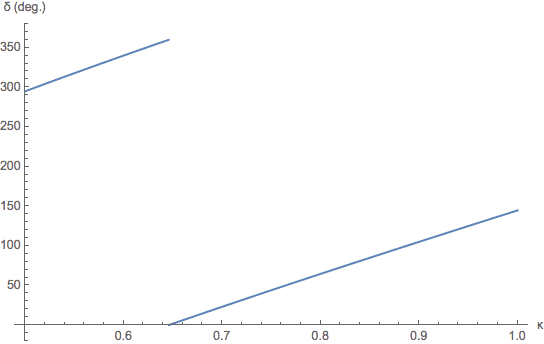

We observe that (a) transit time parameter ##\kappa## can take multiple values, depending on the selected number of tunnel revolutions before the craft exits, and (b) when the craft crosses the origin inside the tunnel, its phase jumps by ##\pi##. To account for these observations, we write the deflection angle as
$$\delta(\kappa) = \mathrm{mod}\!\left\{\left[2\pi\kappa + \arctan\!\left(\frac{2\pi\kappa}{1 – \pi^2\kappa^2}\right) – \pi\right],\, 2\pi\right\}.$$
If we assume that the craft enters at ##\phi_0 = \pi/2##, the valid transits are in the interval ##0.5 < \kappa < 1## and we can generate the plot shown below for that range. The arctangent term is approximately linear and considerably smaller than ##2\pi\kappa## in the specified range which explains the seeming linearity in the plot.
Deflection angle plot
